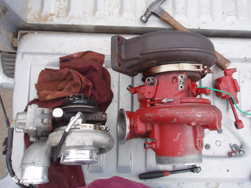

i dont know what the difference is
but heres a he551ve beside a he351ve
Compressor
Inducer 71.75mm
Exducer 108.1mm
Turbine
Inducer 86mm
Exducer 75mm
