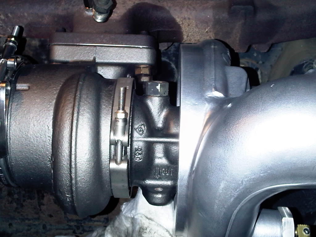

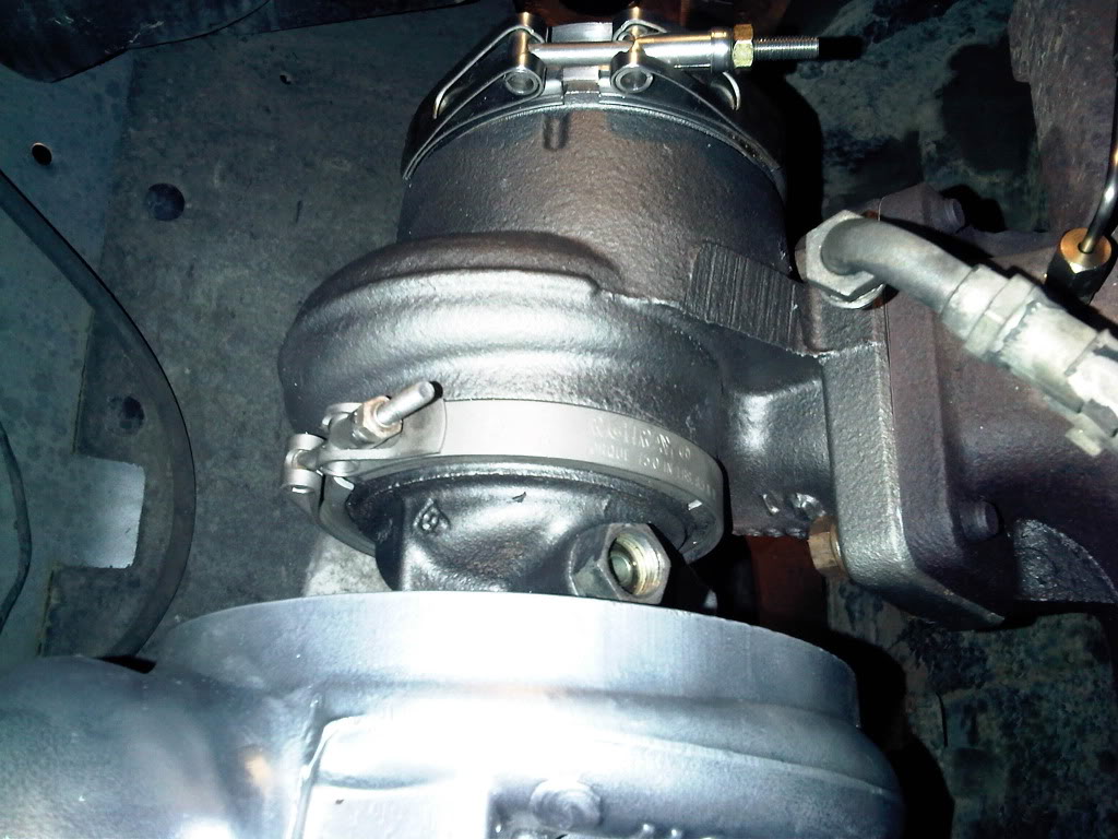

You will want to reclock the centre section (requires pulling compressor and turbine housing off) to get the oil ports vertical.
Some have run with the oil ports off vertical with no ill effects, not ideal though.
See these pics for the unclocked position of the oil ports:

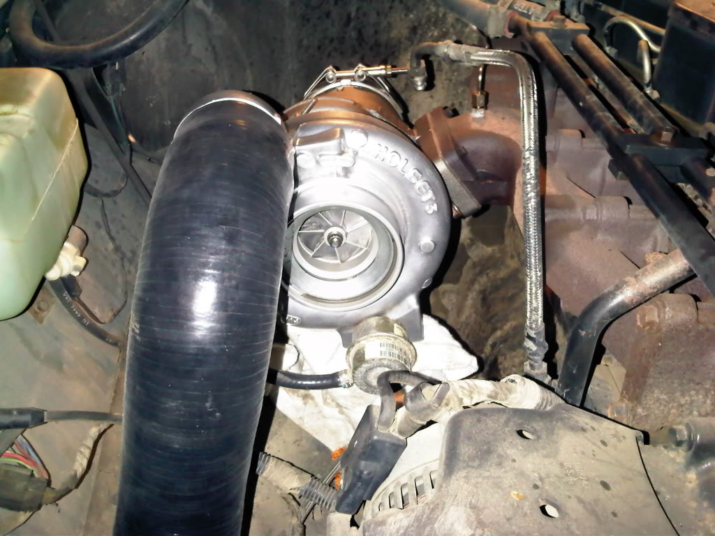

I ended up clocking mine for both the oil ports and the compressor outlet, i tacked my wastegate shut.
