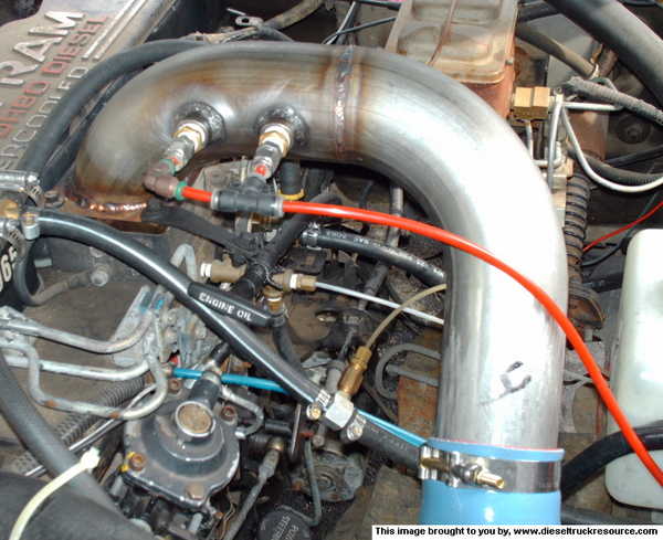

See if you can swap that IC for a 7.3 Powerstroke IC. It fits better and has a little more core area.
The 3rd gen intake sucks, it's necked down had around the bolts. You are better off with a 2nd gen 24 valve unit or better yet a set of CoolerTubes.

what are the CoolerTubes?

Old Jan 20, 2008 | 07:44 PM

Looks cool, where do I get them? Its 3" SS right?

tworlline over on 1stgen.org sells them.
