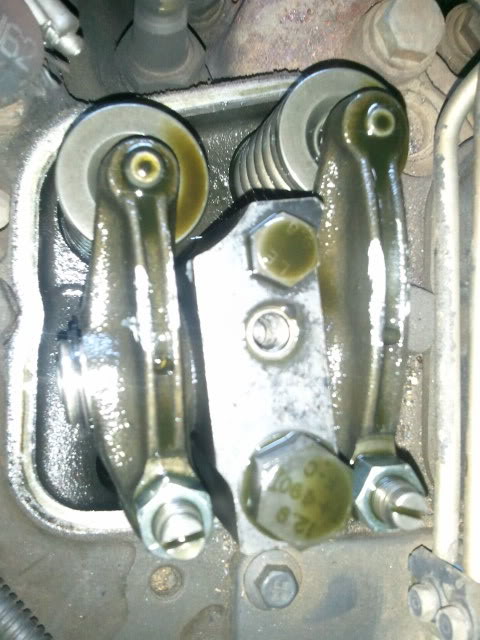

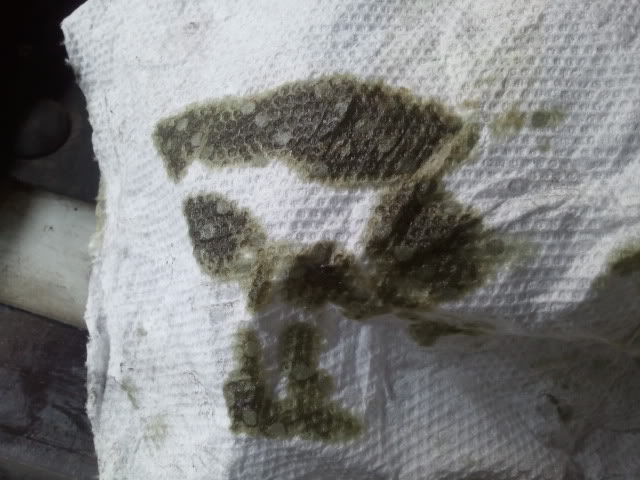

It is the factory lift pump. I took it off tonight to see if there was anything noticeable about it and I didn't see anything. I have some pics of the oil I will uploads in just a minute.
Old Sep 6, 2011 | 07:08 PM
apwcu's Avatar
Joined: May 2008
Posts: 83
Ok here is 2 pictures, one is of oil I put on a paper towel and the other is under the valve cover. I'm not sure how good the green will show up but I'll post them anyways.

Old Sep 6, 2011 | 07:22 PM
BC847's Avatar
1st Generation Admin
Posts: 4,601
Likes: 118
From: Buies Creek, NC
Looks wet to me.
I'd say the paper towel shows the wet in the perimeter of the oil. The second image presents as milky . . .. to me. It may not be big, but it's there.
Dunno . ..
Originally Posted by KRB
Antifreeze in the oil makes it a foamy slimey chocolatey color. Diesel in the oil just thins it out
A little oil in the antifreeze makes the chocolate-swirl . . . . in the radiator? Correct?
A lot of antifreeze in the oil make the chocolate milkshake . . . in the oil-pan? Correct?
I would agree that fuel in the oil would thin the oil with no appreciable color change.
