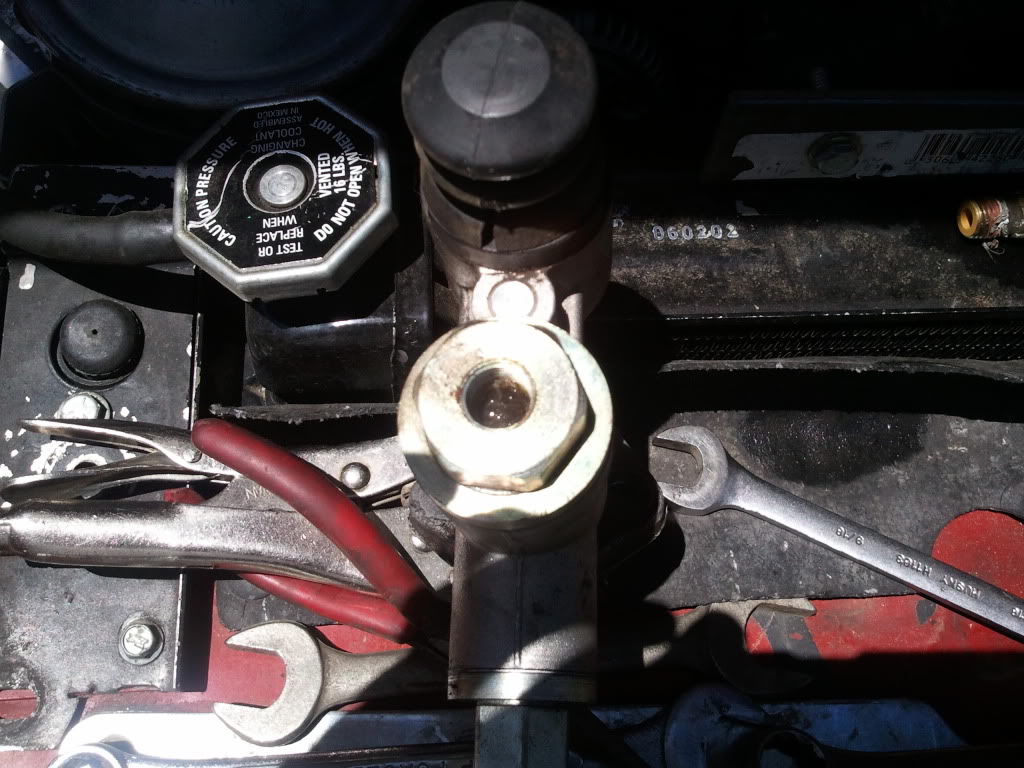

So, the screen in the tank was ripped, but no dirt, so I thought it would be a crack in the plastic line. WRONG! check the picture out, it's the screen on the inlet of my lift pump. It was totally clogged, but loosly, so when I would shut the truck down, the crap would backwash down the tube a ways, so it would run normally, until all the junk would pack back in the screen and shut the flow down. Since I had all the stuff anyway, I did the 3/8" pickup line bomb as described in the sticky and bent and ran coated 3/8" steel fuel line, mounted a big fuel filter by the tank and a diesel pusher pump. Now I have 20 PSI reading after the main fuel filter.
I will drive it tomorrow.

Good find. I have never heard of that happening before. I honestly didn't know there was a screen there.

I got stranded beside the road, log-chained home, and spent days finding that the problem was gook against that screen, hence my oft-given advice to ALWAYS run an easily accessible pre-filter immediately ahead of the lift-pump.
It is much easier to see the problem and swap a cheapo filter, than to be disecting a fuel-pump beside the road.
I route extra fuel-line, such that the pre-filter is up high, under the hood, instead of down in under there where one does not want to be a crawling around with his Sunday-go-to-meetin' clothes on.

Good advice. I put in a Fram racing filter like I used on the HEMI car, then a Mr. Gasket 12D pump pushing to my piston LP.
