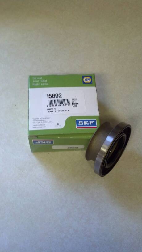

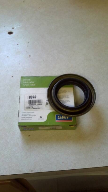

I would do the inner axle seals for sure and the pinion seal. It does require pulling the guts out of the pumpkin but its not bad as long as you make sure you make sure all the shims stay together where they need to go and you mark the caps and the bolts. Here's the part numbers and pic's just to help a little. These are Napa part numbers[ATTACH]

Thanks for the pics of the Napa seal numbers, Bryson711. Not sure if I'll do the pinion seal though. Never pulled a Dana gear set apart before.
You don't have to pull it apart. Its just 4 bolts and the caps come out and you can lift it out as an assembly. You will have to pull that out to do the inner axle seals. The seals install from the inside of the pumpkin. Also to get the pinion out you just loosen the nut holding the yoke on the axle and the pinion comes right out. Replace the seal and put it back in. Its not a bad job its more intimidating than anything. There are no crush sleaves on the pinion, just a few shims. Just make sure all the shims get put back in the same way
