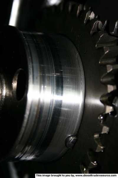

aicomp,
I had some pretty deep grooves in mine too. I didn't use a speedy sleeve, but I'm quite sure one of these days I'll wished I woulda. The front groove is/was HORRIBLY deep, the inboard one, definitely not as bad as the front one, but it's the one that worries me because that's where I think she'll spring a leak one day!
Good luck!
