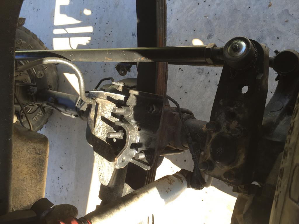

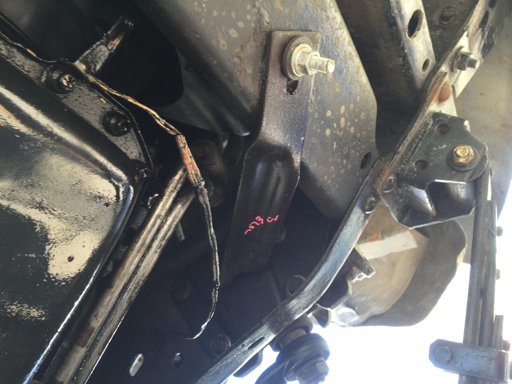

Here's a few, would adding thicker shackles help and possibly front traction bars?

Okay, I can see the springs go side to side when I turn the wheel and it's causing the spring to make a popping noise

If you're seeing flex that might be related to the shackles, I would investigate that first, take the bolts out and inspect the leaf spring eye and frame eye bushings and the bushing sleeves the bolts slide through. Also, are the u-bolts tight on the axle?

Ford ran a trackbar because of the relatively unstable fwd shackle arrangement.
I would run beefier shackles, and make sure your leaf bushings are in good shape (or go poly). I wouldn't run a stabilizer until you fix the problem.
