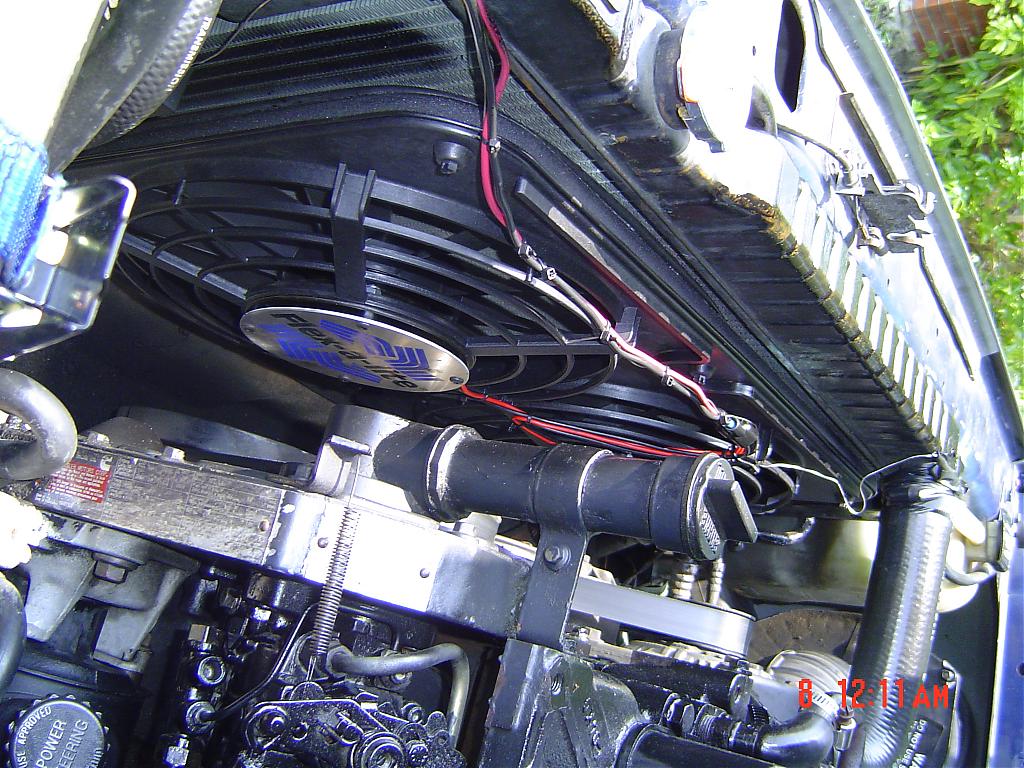

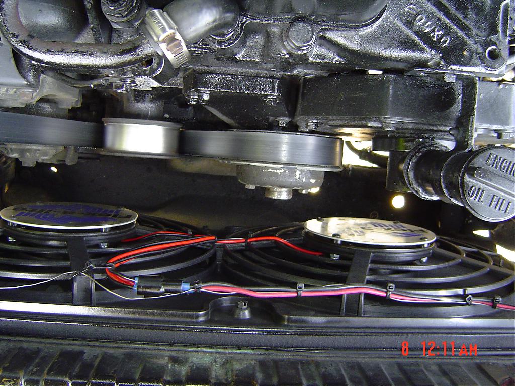

cool i finally got it it will just fit btwn. my head lights it actually closer to 3 1/2 feet wide and tall enough to be hanging below my grill when its just below my hood. im gunna have alot of fab. work in my shop in the next couple of months, o by the way it was a freebie it had a pin hole in it and wasn't warranty so instead of throwing it out the boss said why don't ya bubble wrapped it and take it home "cool boss" so i did. now i gotta chop up the front of my truck good thing i got two low pro elec. fans already installed.

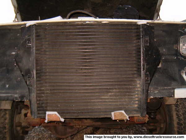

How big is the IC? Mine's from an '06 Dodge/CTD and I had to cut the front of the frame off to make it fit...You can upgrade your current turbo for a few hundred bucks and it will match your stock injectors nicely.

heres a pic of the future monster overkill cooler 42 1/2 x 26 inchs

I cannot imagine how in the heck you would ever get that thing stuffed in there.

Where did you get the fan from? What kind of CFM will it flow? I'd like to do the same.

got the fans from a local race shop but are online there FLEX-A-LITE fans not the best but do the job don't know the cfm rating but they have two stages all on a temp. switch recommend putting the sensor in the upper hose for beter heat transfer.to fit the cooler i will have to do alot of fab work will document it won't be for a while.
