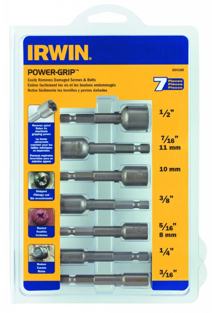

I know a lot of you folks that did this mod had no trouble getting the stock bolts out with your T30 torx bit, but spaz's like myself didn't have it so easy. After spending a few more bucks on needle nose vise grips, misc bits, and even random types of EZ outs all I did was keep stripping/rounding off the bolt head on one of them. After numerous attempts I finally gave up which is not the way I was wired/designed. Bugged me for 8 months to stare at this Baggie of expensive items. Figured if I ever needed to pull the vac and power steering pump I'd try it again. The other day I was cruising thru my local Ace hardware and saw a set of EZ out bits, but styled like a nut driver meant to go right into your chuckless makita drill. I said well that would give me better room as the same manufacturer makes the same concept but only in a socket style, 3/8 drive which, when put on an extension, would run into that blasted vac pump and not give me the angle I needed to get a bite on the bolt head. Well these nut driver style, when adapted to a 1/4" short socket and 1/4" ratchet, popped those bolts off 1st try. Soon as I got it on the head of the bolt, I applied push pressure, and one twist and the bolts cracked free. The maker of these is Irwin Power Grip, part # 394100. 7 piece set for about $22. You will be using the 10mm driver out of the set. Just thought I'd pass this on to whoever has put this off due to those stubborn bolts. Now you ask me "how does it drive with the mod?" I'll know tomorrow when I get up. Hopefully this'll clear up my forever haze I've had from my PODs. What a great week so far- new brakes and another mod towards performance! I know I know... Sounds corny. PS- I would post a pic, but stupid that way. PM me your cell and ill send you the pic of how I rigged the Irwin tool

Hey Arnold,
Is this the kit ?
Just ordered it and I'll let you know how it works out...
T.
Attached Thumbnails Finally, 8 months later and the M&H KSB spacer is on!-71a-wa4ky3l._sl1500_.jpg

Originally Posted by NJTman
Hey Arnold,
Is this the kit ?
T.
That be it! I know you know. Replying so everyone else knows
