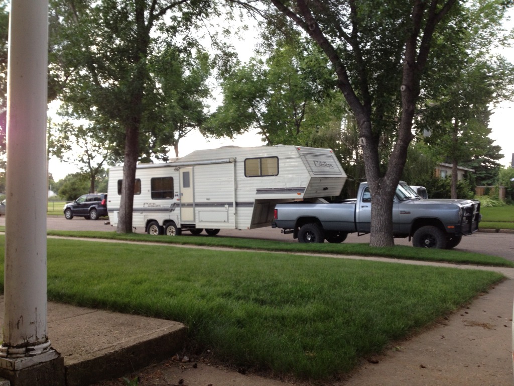

Yes, i do have new head bolts to put in but may just go ahead and do studs when i install the compounds. I think my stock timing is what is saving me so far with the HG, i do have the M&H spacer though.
I looked it up and i was 28psi with stock pump and it went up to 30 with the denny t pin.
I rarely see 40psi though, Only if towing hard up a hill. Normal would be 20-35 while towing up most hills.
I have my fuel screw turned in 1.5-2 turns i think. I set it so i can pull my 9000# camper up a good hill, 4th gear, pedal on floor and not go over 1250F.
