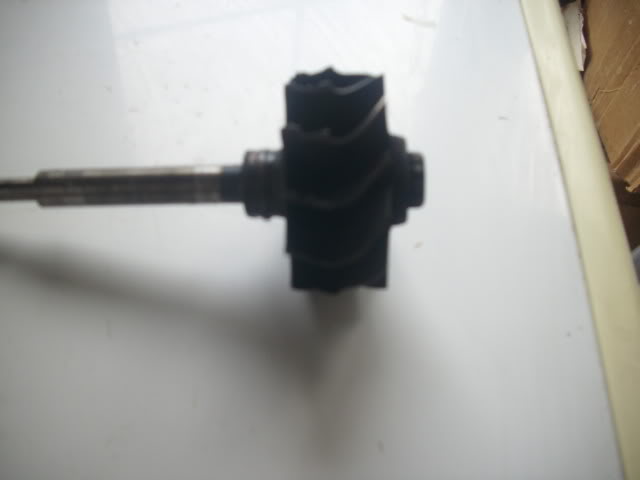

#2, pull the exhaust housing off and inspect the turbine for damage.
I've picked up HE351cws that were tight and pretty, that looked like there wasn't a thing wrong, then pulled the exhaust housing off and found the turbine looks like this:
A few minutes now beats the hell out of putting it on and pulling your hair out trying to figure why the heck it won't spool worth a darn.

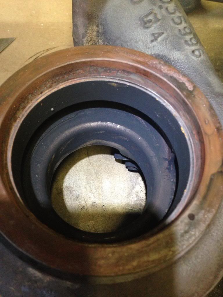

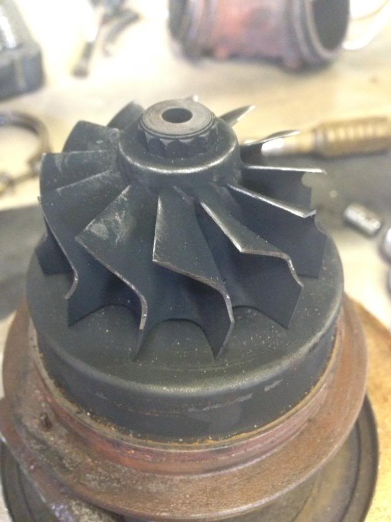

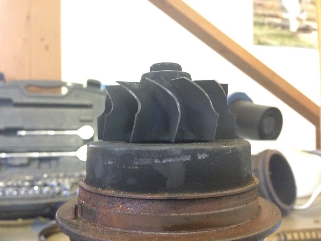

dang. didnt realize those were so big
all looks well there huh?
we'll see about the other side when my amazon prime snap ring pliers show up tomorrow.

That's a very nice unit, by the pics.
I made my own pliers to work on them.
Junk Harbor Freight needle nose pliers of various sizes and angles, with careful grinder work, make excellent snap ring pliers for these turbos.

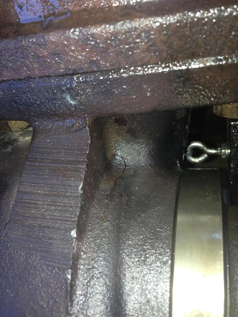

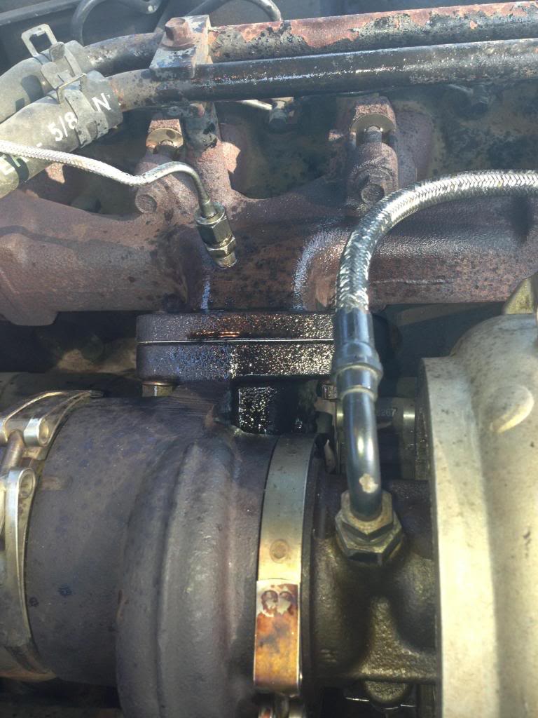

One heck of a way to start my weekend...
i guess i need another core.
dang

tons of white smoke, oil entering the exhaust housing i think. does that mean the center section of the turbo is toasted too?

never seen one cracked, bummer.... ill pm a source for parts

Does this sound like i need:
rebuild kit
exhaust housing
Old Jun 15, 2013 | 08:07 PM
sooty's Avatar
Posts: 1,260
Likes: 25
From: hesperia ca.
rebuild kit and bearing housing
