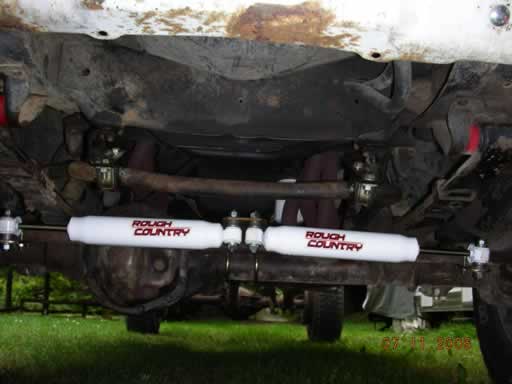

http://s978.photobucket.com/albums/a...ersteering.jpg here is a picture of dual shock's with hand made mount's
