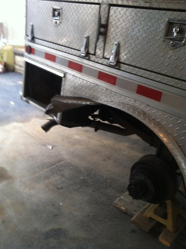

Here they are:
What happens when a heavy tire and rim hits aluminum @ 70mph......CRUNCH....RIP.....TEAR........!

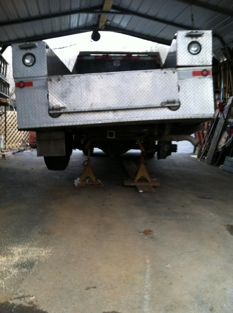

Note that the axle housing is level and the bed is not.....Ahhhhhhh crap!

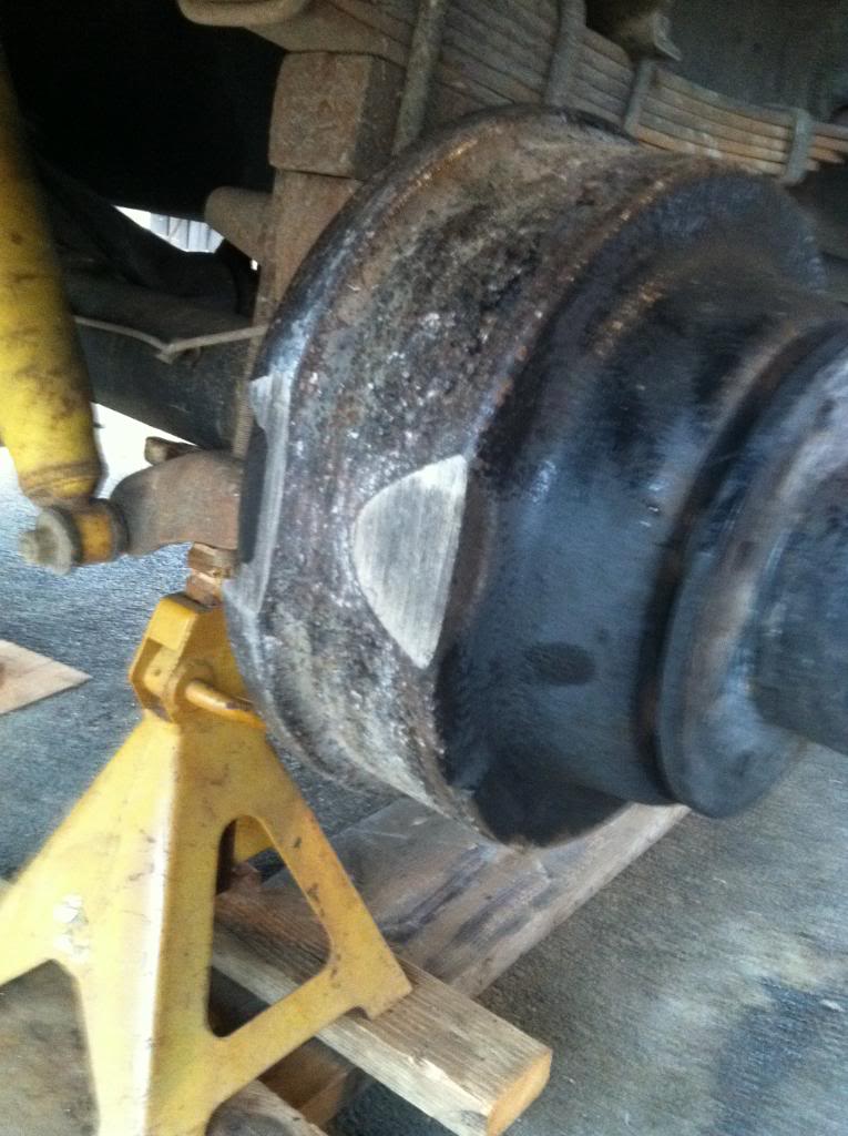

Can you say "flat spot"?

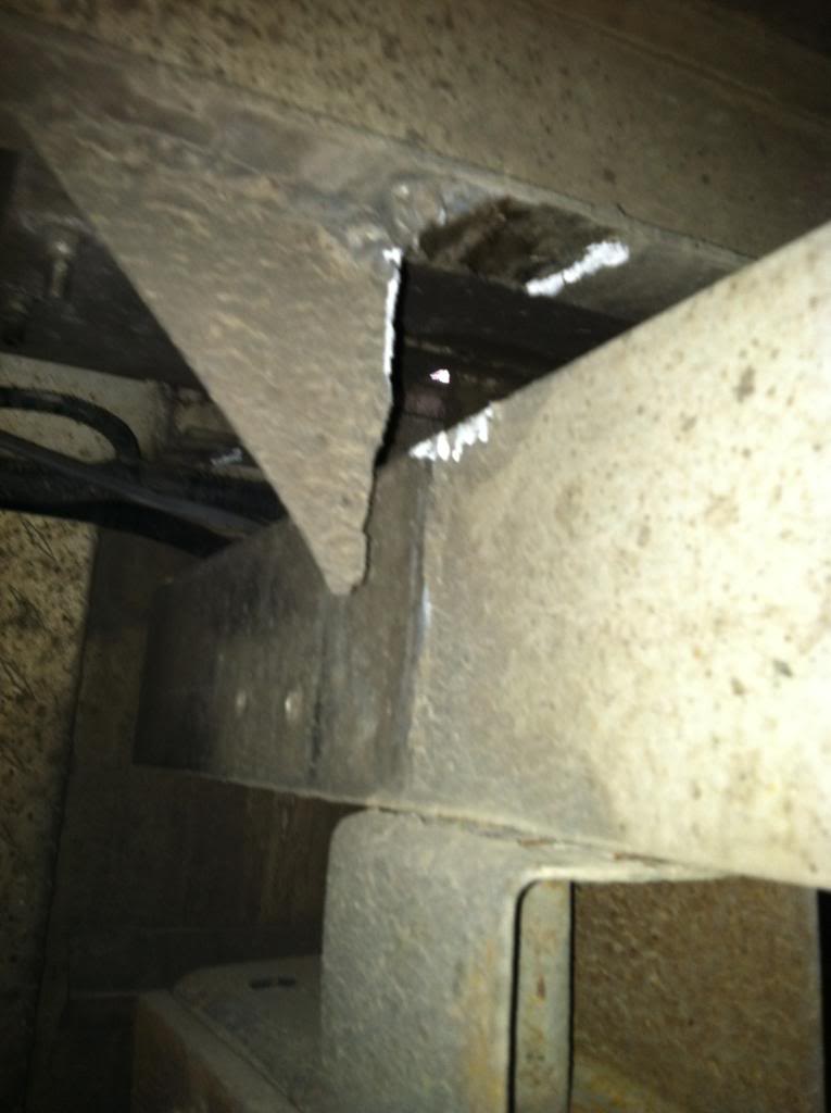

A little bed separation.
