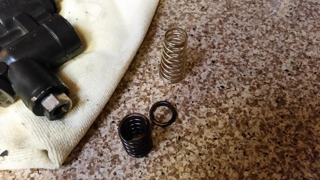

Otherwise, I used a bathroom scale to measure how much pressure it took to move the 2nd gen lift pump piston to full draw. Hardly scientific, I know, but I figured I might get a roundabout spring rate. It came out to 38lbs. I'm going off of memory here, but I thought those lift pumps had 27lb springs in them. I chalked it up to my method being pretty fuzzy.
...then I pulled it apart and found this:
That black spring at the bottom of the photo is the factory 2nd gen spring. Since removing coils from a spring increases the rate, it made perfect sense that it would read too high on the scale. I started to wonder if my method wasn't at least in the ball park.
The shiny new spring above the broken spring is the low pressure piston pump spring. I didn't have to end up paying the $50 for one because a friend happened to have one laying around and was feeling charitable, I reckon. After checking the piston and bore for damage that the broken spring may have caused and finding it in excellent condition, I cleaned the housing out, dropped the piston back in and installed the new spring. Since the new part is from a low pressure agricultural unit, I know it's supposed to be at about 12lbs. Back to the bathroom scale, just for poos and laughs...
12.1 lbs. I'm feeling pretty good about it, so tomorrow, after I get the lift pump spacer cut off of the 2nd gen fuel heater, I'll throw this beast in and let everybody know what kind of post-filter pressure readings I'm getting.

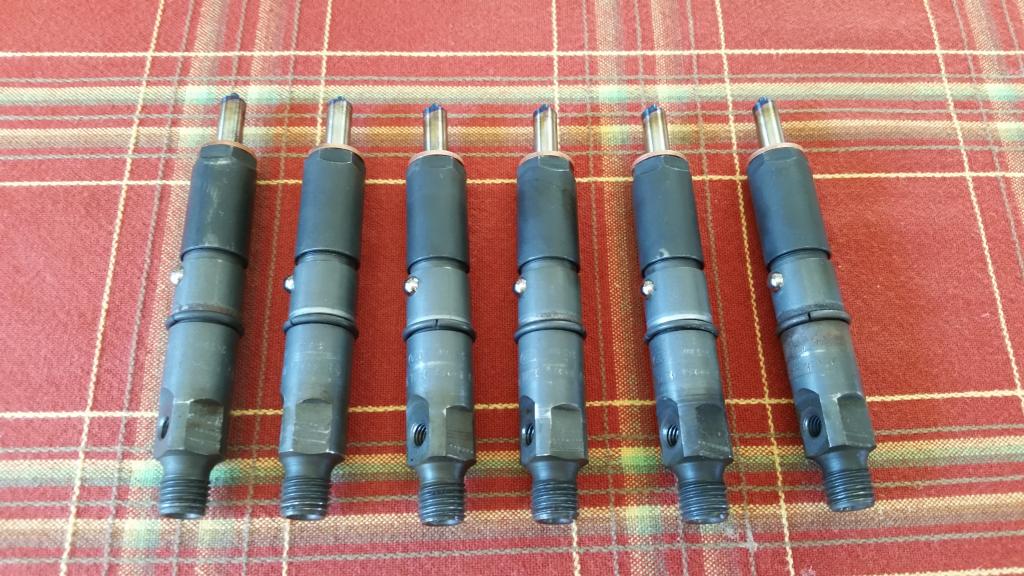

Today a buddy came by and dropped off a set of DDP stage 1 sticks for free. I hear they're not much better than stock (DDP claims 50rwhp, but you know how that goes), so I'll try 'em out and see. I still haven't had a chance to fab a place for my gauges or get the spacer for the lift pump. Maybe I'll be able to get that stuff done in the next day or two.
Anybody have any experience with the little DDP injectors?
...they're in but the truck runs real rough. Numbers 5 and 6 have teeny tiny little bubbles coming from the injector collar, so it's got to come back apart.
Some people claim that there's an injector to blame, but I know it's my own damned fault.
A quick update:
I kept having stumbling issues with the injectors so I put the stockers back in. I took a couple over to David and he pop tested them. They were right where they needed to be at around 120 bar and had good spray patterns. We've pretty much come to the conclusion that skipping the "take it out on the road, put it under load and blow some smoke" procedure is what did me in. It's probably better since I'm finding myself skipping things I should be doing first.

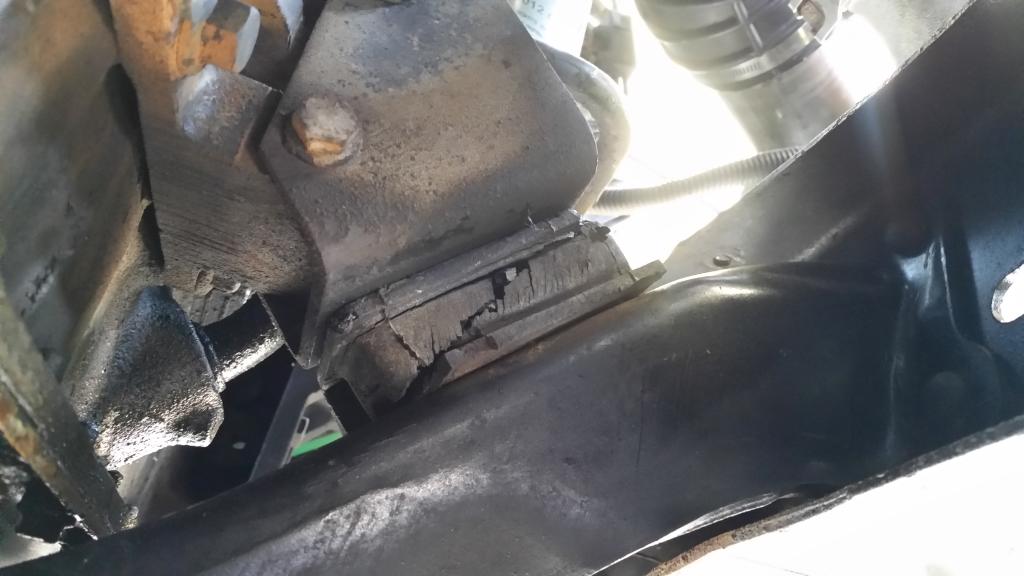

The lift pump will not be getting done today. I crawled under there to case the joint before the job and found this:
So,the lesson for today, especially when putting a Cummins in a Ramcharger, is that just because it fits, doesn't mean it's right. The 318 motor mounts are not suitable for the swap. The one pictured above was in excellent condition when the diesel engine was installed. There was no twisting or binding, I've done no wheeling, racing or launches under boost. These things just can't handle the torque.
Interesting. The pan does look too close to the crossmember to me. That would also explain the serious lack of clearance preventing me from running the factory front sway bar. Thanks for the info.
A pair of motor mounts are on the way (Anchor p/n: 2710) and will be here in the morning. I decided on these after reading this thread: https://www.dieseltruckresource.com/...t158399p2.html

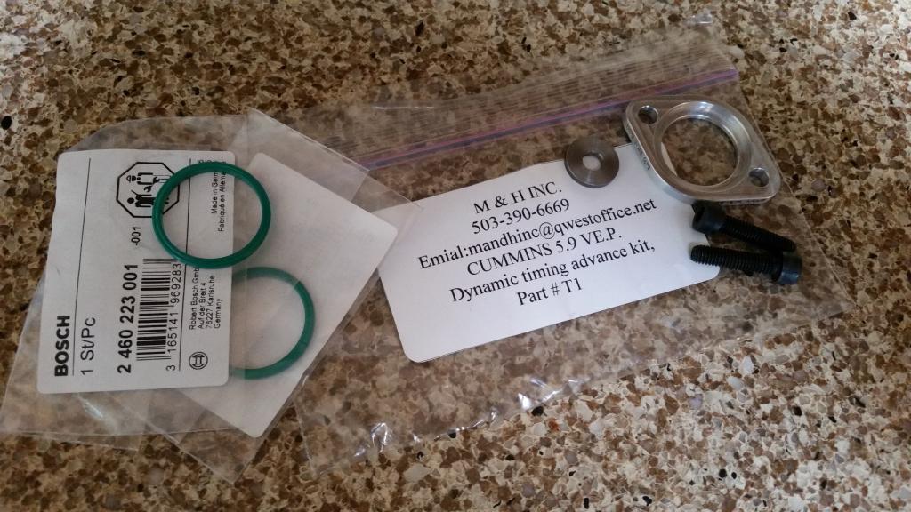

I still need something to do today, so I think I'll go ahead and throw this stuff in:
I'll take pictures and do sort of a mini write-up on the installation. Since my static timing is in the factory position and I haven't tampered with the wiring to the KSB, everything should jive properly and the spacer should fulfill its intended purpose. I'll let y'all know how it goes when it's in.
I saw one crew cab swap where the oil pan was ON the crossmember due to re-using squashed out '76 360 engine mounts.
