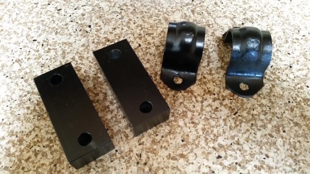

Body roll is a bit of an issue with Ramchargers; at least it has been with the several that I've owned. The factory sway bar from this truck won't clear the Cummins oil pan, so a buddy of mine who works at John Deere scored a few pieces of bar stock and made some spacers. They'll go between the frame and the bushings, effectively clearing the oil pan and stopping some roll.
Once the sway bar itself is cleaned up and epoxy coated, I'll snap a photo of the setup so the results can be duplicated by anybody who might happen to come across a gas sway bar and wants to put it in their front end.

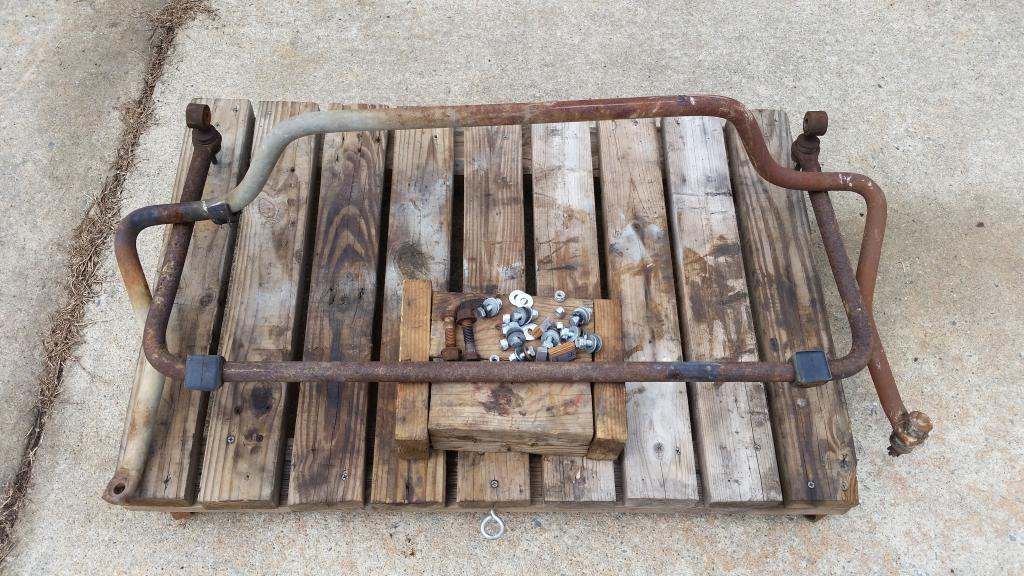

I was talking to BC847 the other day and we were discussing my plans for the suspension and he says "hold that thought" and walks off. A few seconds later he comes back and hands me a rear sway bar that matches the front in diameter. Now I can clean this one up and throw it in, too. Thanks again, David!
Again, when it's in, I'll get a picture or two of how it settles in there.

My front sway bar spacers aren't thick enough and the bar still kisses the oil pan.
I got that old "measure twice, cut once" idiom backwards again!

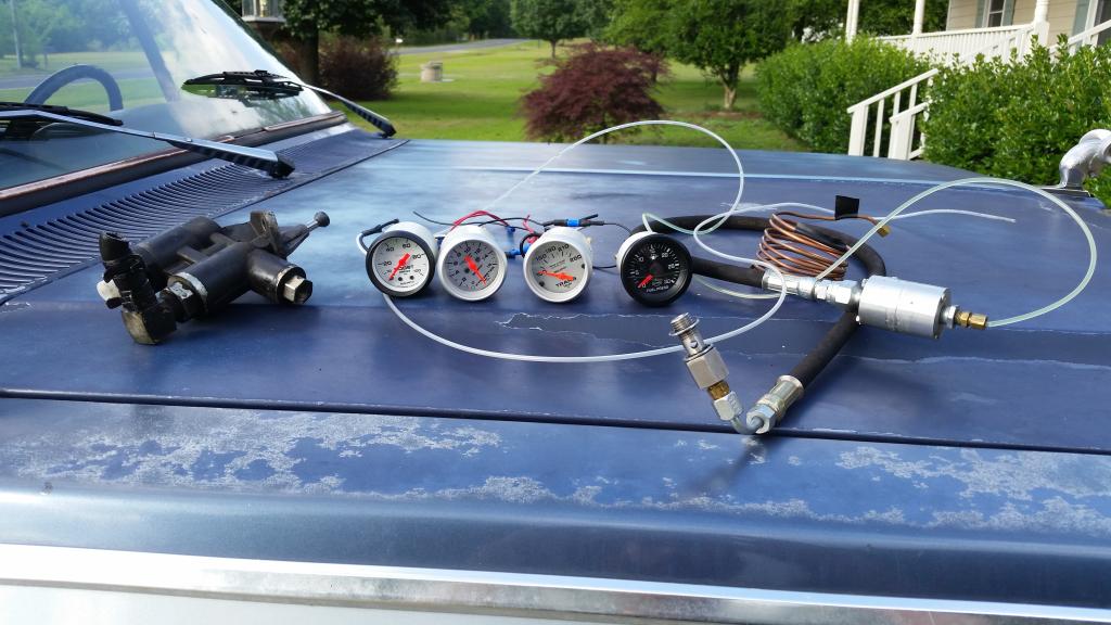

I just picked up some good stuff for the Ramcharger and I'm psyched!
First, I got a 2nd gen lift pump. This week I'll order the 15# spring from Hungry Diesel (I wish they weren't $50...jeez) and throw it in there. That ought to take care of the fueling issue on the top end.
Second, I got an Isspro fuel gauge, isolator and hose/fittings. I want to hook that up before I do the lift pump so I can get a baseline.
Next, I got Autometer trans. temp., boost and EGT gauges and all the wiring/tubing. They don't match but the price was right for the whole shootin' match (freeeeeeeeeeeeee!). I'll replace the Autometer stuff with Isspro stuff later, but at least I can keep an eye on what's going on under the hood now.
I also ordered the 3200 governor spring, so that ought to be here on Tuesday or Wednesday.
All I need now is some way to mount these gauges (can't decide which direction to go; I know I'll order the steering column pod from Geno's for fuel pressure, but I hate 1st gen pillar pods. Wouldn't be so bad if they didn't point at the moon).
