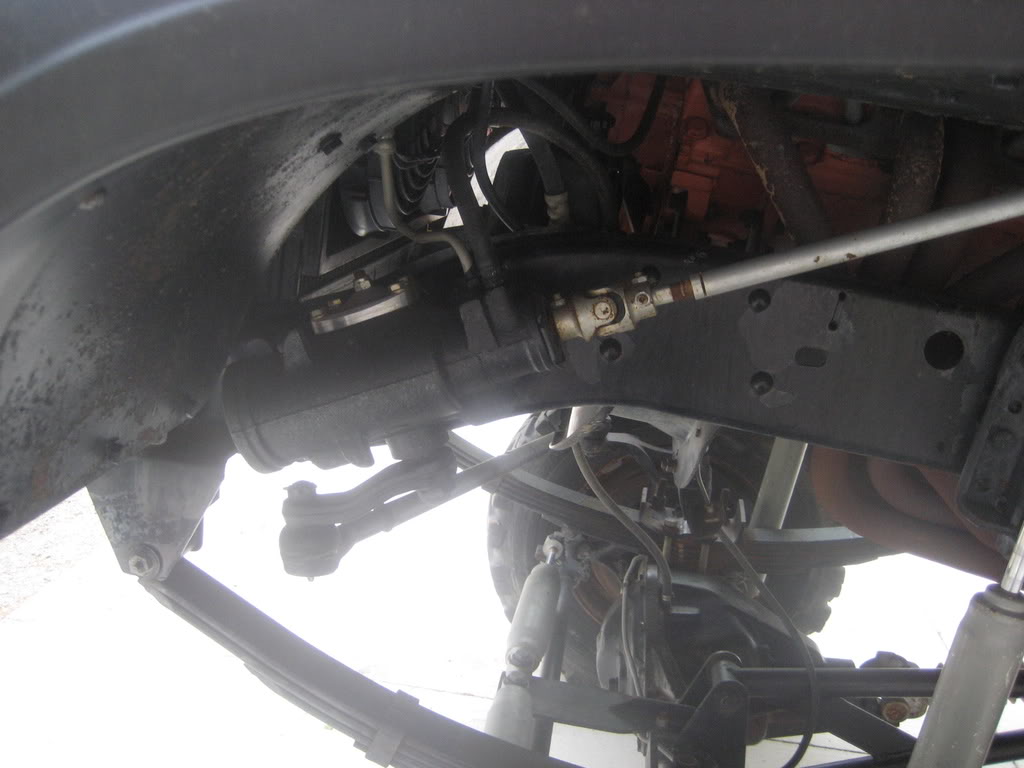

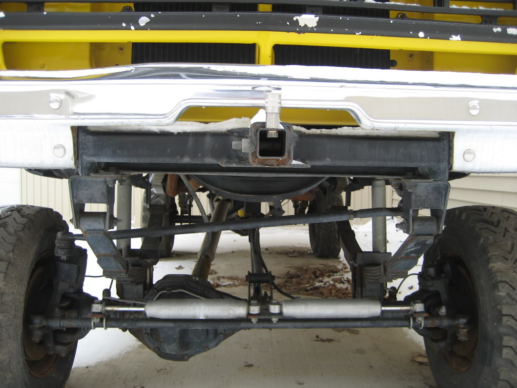

But, I have done a cross over steering setup on my wheeling truck.. Mounted the box in the 2wd spot.. Used 5/8" bolts and nuts drilled out the box to 5/8" to pass the bolt through.. Didn't brace the frame and haven't had a problem for 3 yrs running 44" boggers.. I went with an old style reverse roataion gear box to run the pitman arm in front of the box, wan't to keen on sending the drag link under the cross memeber... But on a daily driver, I've seen some pics of guys that done it pretty nice on here.. They also put on a track bar which makes it even better.. Here is a few pics of my cross over setup..

do they offer another brace for the 2wd trucks?? Cause when I searched for the all I found was a 4wd one, which I bought for the 92. So for the cross over in moving the box to the 2wd spot, one will most likely have to fabricate there own steering brace.. One thing nice about the 2wd location is the box sits flush to the frame which lessons the abilty for the box to twist on the frame.
