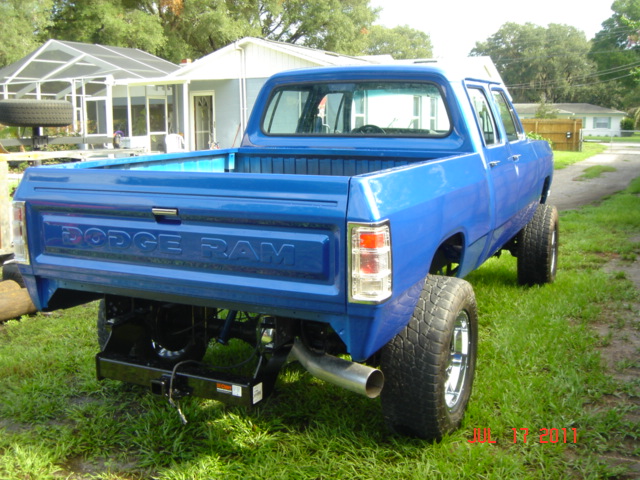

hey guys im was working on the truck some and my new curt mfg class V hitch came in and i installed it. only problem is that when bolted up its around 10" off the ground and my truck is on 35" tall tires! has anyone else run into this??
picture for reference...

That doesn't look right. A Class V can have thicker steel, more surface area on the mount, a 2" 1/2 receiver, or a larger hitch frame overall, but it should fit/look very similar to a Class III or IV.

I hope that you don't mind, but I enhanced the pic to make it easier to see:
http://www.flickr.com/photos/63170901@N03/5948114039/http://www.flickr.com/photos/63170901@N03/5948114039/ by http://www.flickr.com/people/63170901@N03/, on Flickr
Looks waaaaay too low tome Mark

That must be the wrong hitch or something. I have a hitch on my 89 and 92 that was made for them and the reciever is just under the bumper. That would be well under your bumper if you had one. That could drag pretty easy. I would give the seller a call and double check the part numbers, or it even could have been missboxed.

I believe that hitch mounts not under the frame rain, but on the top side. That will put it right about perfect under your bumper. Try mounting it there and see what you come up with.

Besides being too low, I would think that the leverage from a 10000 lb load, on a hitch hanging that low, would be tremendous. It also looks, to my bad eyes anyway, that the side pieces that angle down, appear shorter in the PDF than in the foto. Maybe it's one of those 1 size fits none things...Mark

Looks like you got the hitch for a drop bumper.
i guess ill have to call them as i dont have a drop bumper and the add says nothing about it????

Looks like it might be for a drop bumper to me also. Are those clear tail lights or am I seeing things?
