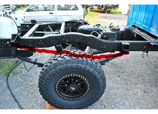

Enafzigecan you give me the measurments between both shackles. Were the red line is the measurment I like to get thanks

Sure!!! ...and welcome! Give me a few hours...

Ok, I think I am going to do like you did on your truck, but with 4in skyjacker front springs. I just dont know witch flip shackle I am going to use for the rear. I am thinking about a stock dodge or chevy hanger or jungles hanger and either a 6 or 8 in shackle.
thanks
jmd

From eye to eye straight across on my rear leaves is 65", and I used an 8" shackle.
