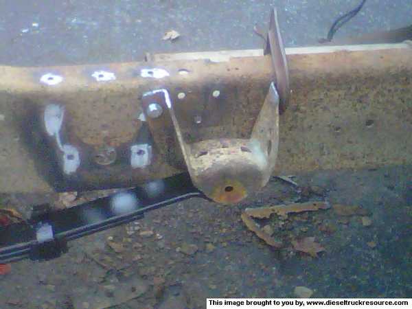

this picture is just the main leaf laying on the spring perch you can see where the old spring mount was
I decided to use the chevy spring mounts instead of the factory dodge ones mainly because the spring eye bolt was 9/16 versus 3/4"

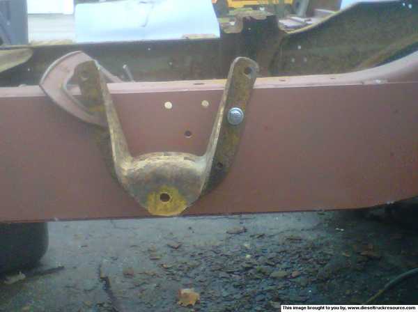

i used the top forward original mount hole to locate my new bracket. one problem that still needs to be addressed is the bed mount needs to be mounted in the center of the new bracket. you can see the three holes in the above pic, it ALMOST fits...

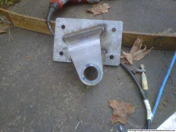

you can better see the bed mount holes and the chevy spring mount befor i modified it.

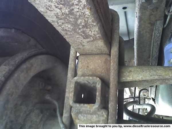

as far as the shackle end of things i decided to go with a shackle flip

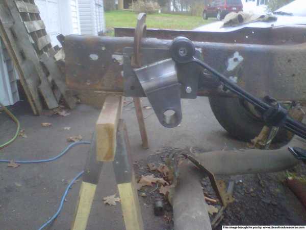

in this pic i have the truck blocked at its original ride height and the new leaf just sitting on the perch. you can see how much it is going to lift the truck and i have a 6" shackle still needing to go in....

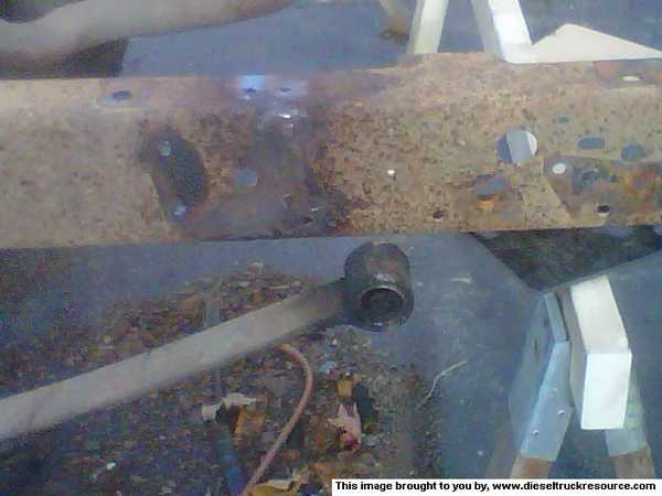

another picture.. the truck actually sits lower but it is blocked up in the back in this pic...

How did you like bending that bottom web in place on the frame? Looks good, and I think you are smart getting away from the " pricey " dodge hangers.
Old Nov 15, 2010 | 06:01 PM
bradshaw106's Avatar
Joined: Apr 2008
Posts: 476
not bad nothing a set of torches and some c-clamps couldn't handle.....
