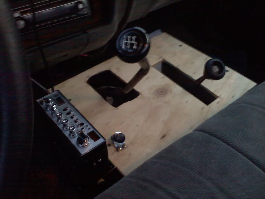

Well, I just came home with a Cobra 29 WX NW ST. Getting a center console built tomorrow around the shifters to add a few switches, lights, the CB.... OH! And a place for my coffee cups.

Good idea on the location...
Here is what I spent 6hrs to get just right...
And I have redone the design 3 times. Getting some other things thought out. I am adding an extra direct-to battery fused 12v power outlet, a switch to run another power outlet that will have my blue LED Emergency Response light and wig-wags, cup holders for both driver and passenger, and a inverter hookup for other things. That cable there is my shut off cable as the shut down solenoid quit on me at the last pull I did...

Put some carpet on that and trim around the holes to make them square and it would look pretty good.
