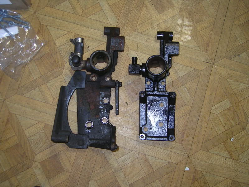

Hey Bearkiller,
The lower hose outlet needs to be replaced using the intercooled style bracket since this is what the compressor mounts to, if you compare the C-171 and the Sanden SD709 compressors together you will see they mount different as night and day, also the suction and discharge lines are different with the C-171 mount off from the top of the unit while the SD709 connections are on the end housing.

Just curious, why the need for the different water-outlet just to swap compressor types ??

From my viewpoint of those outlet brackets, it appears to me that the difference could be employed on a fabricated plate-adapter that attached onto the early set-up.
