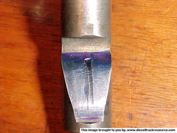

I have noticed the Bully Dog pins are kinda soft and can show were very soon, just keep an eye on it.
Do they start to look something like this? This is one of my homemade ones. Didn't get it hard enough, the next ones are at least 40Rc and don't forget the stock pin is hard chromed.

Gee! That looks just like the one I bought. I took the little pin out, when it got stuck in the bore, and rounded off the end that rides on the AFC pin. Then I smoothed thehramp with my Dremel tool. So far it hasn't given me any problem.

Wow thats some serious wear on the pin. The governor seems to really push out that pin at the top fueling area.
Did you use drill rod?
