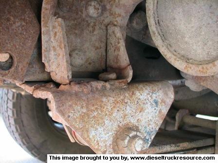

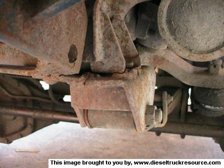

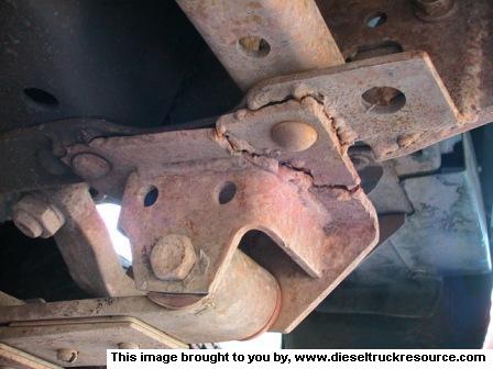

Ok. So a buddy and I were looking over the suspension of my truck looking at how worn out my leaf springs are and I found this...
Previous owners broke the bracket and did a horible job of welding it and now Im stuck with broken welds and bracket.
So yeah, if any of y'all got a 4x4 first gen, it wouldnt hurt to get under there and check your bracket for any bends, hair-line cracks or in my case, ignorance and bad welding.

I plan to eventually replace the brackets with new ones along with my leaf springs, shocks, bushings, ect.. but as a temp fix Im gonna take it to the "best welding/machine shop" in town and have them re-weld it.

Hows your fabbin' skills. That looks horrible! To me it looks like any downward articulation would remove that bracket from the frame. Theres a way to build a spring bracket. I built a set for a ramcharger once. The stockers look all convoluted but the ones to build are easy. Just a lot of plate and some sqaure tubing. For sure tons cheaper than anything from the factory and I guarantee tons stronger. As far as shocks go I run pro comp 9000's. I like 'em.

I think before I spent that much on brackets, I'd try grinding it out and re-welding it properly. Keep an eye on it for awhile, maybe OK, never know...

there is a thread somewhere on pirate 4x4 in the dodge section detailing someone's buildup on a ramcharger where he built a sweet, heavy duty front spring hanger setup with a crossbar that dies the two hangers together.
