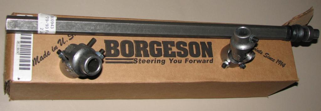

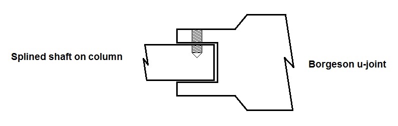

Old thread, I know, but from what I've read, no one has verified if Borgeson has made any changes to their design yet. At this point, it's been almost eight years since this was originally posted. I own the shaft pictured below, and I had a thought to fix any potential problem.
I plan on drilling a hole into (but not through) the splined end of the factory steering column. I will then install the Borgeson shaft, thread a tap into the setscrew hole, and then tap the newly drilled hole so a longer setscrew can engage both the Borgeson and Dodge parts. I'll buy a longer setscrew if I need to. See the pic below if you're confused. This will keep the u-joint from ever sliding off. The setscrew will experience minimal torsional loads, mostly single-shear stress.
Attached Thumbnails Borgeson shaft safety alert!-borgeson-000943.jpg   Borgeson shaft safety alert!-borgeson-fix.jpg

  #68
maybe368's Avatar
Posts: 5,311
Likes: 566
From: Phoenix AZ
I plan on drilling holes into (but not through) the splined ends of both the factory steering column and steering box. I will then install the Borgeson shaft, thread a tap into the setscrew holes, and then tap the newly drilled holes so a longer setscrew can engage both the Borgeson shaft and Dodge parts. I'll buy longer setscrews if I need to. See the pic below if you're confused. This will keep the u-joint from ever sliding off. The setscrews will experience minimal torsional loads, mostly single-shear stress.
Mine has been installed since '05 without issue, but let us know how it comes out...Mark
DONT DO THATThe steering box shaft is hollow and flows with fluid
Thanks for the heads up. I actually think it would be redundant to do it to the bottom shaft anyways because gravity will keep it on. I'm definitely going to do it to the top. Oh yeah, I need to update my sig. This is going into a 78 crew cab dually that's getting a Cummins 4x4 swap.
**I've since updated my previous post IAW Bobva's advice and signature, even though my sig won't show up here.**
Last edited by 69HemiGTX; Jan 29, 2015 at 05:41 PM. Reason: Updated previous post and sig
