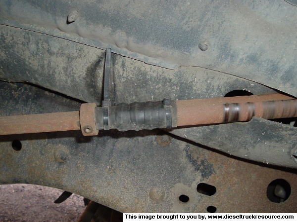

Here is how I fixed mine today.
All I had was some 2" tape for now setscrew is tight, I really wish I would have painted it when I first installed it.

I decided to go with one small screw tapped into one side and loctited. I love welding stuff where appropriate and fabbing up custom parts, but not here:
http://66.17.171.114/PhotoAlbum/Cars/Pics/CTD_94.jpg
Not sure why you guys are moving that set-screwed collar, maybe I didn't read the instructions. Didn't look to me like it was intended to be moved, or used as shown above. That would interfere with the rubber boot.
I'm sure Boregenson recommends welding it. What's the best way for them to avoid any potential liability?
