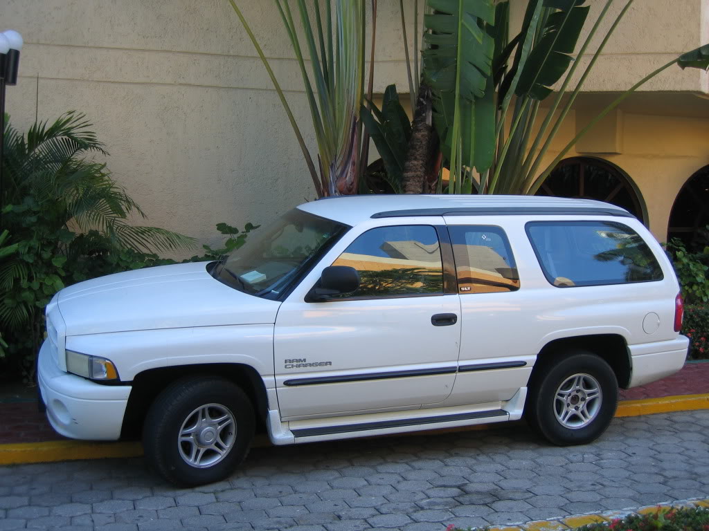

Have a safe trip and bring me back a Gen 2 Ramcharger!
No seriously I will pay well!
Are you saying that all the Gen 2 Ramchargers defected to Mexico?!?
I'll keep an eye out!

To my knowledge that was the only place they were sold in North America
