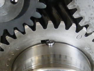

Well after having a inner timing case bolt thoroughly ground my truck for a few months I'm driving and smiling again.
If you saw my last thread "getting frustrated" you can see some pics that caused all the grief.

He helped me take off my damaged timing gear, and get the crushed locating pin out. Then get the new gear on and button up the front end.

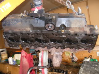

Next it was time to take off the head and replace the head gasket and then reassemble it. He did my valves and the re torque and set up my fuel pump after I rebuilt it.

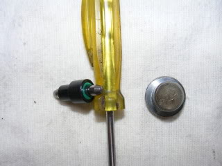

This is where I found out from the sticky that I was missing the crush washer, the protective cap and the retainer from my fuel pin that someone else had neglected to put back into the fuel pump.
Inner timing case bolt aftermath. Again members responses made light work of this disaster.
Head gasket time.
Same as above, all ready for the install.

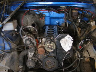

Back together and ready to run!!!!
Head gasket time.

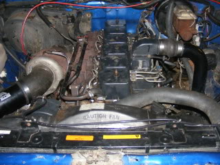

I haven't seen one of those heads in awhile. You're going to have to post some pics of the entire truck.
Looks like a pretty clean truck. If you want another VE head let me know I have a spare head that's in decent shape.
