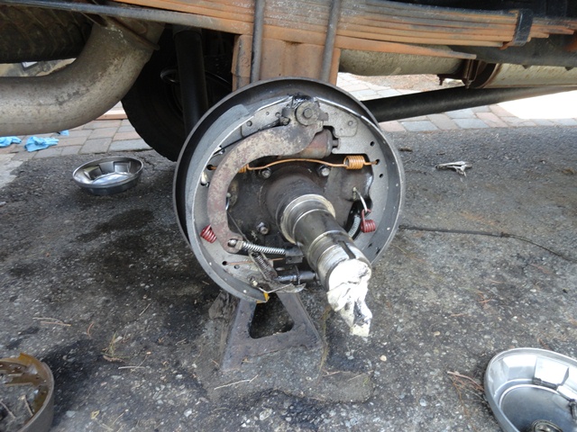

Old Nov 6, 2011 | 05:03 AM
  #35
You can see if the gear lube catcher works, it alerts you to your problem. Oil gets deposited on the outside of your rim / tire. It worked great on the passenger side, but didn't do squat on the driver side. Go figure.
second pic shows the seal just fell apart. (red arrow) This is kind of strange considering it took several weeks to show.
3rd pic show the new seal that fits the best Green arrow shows the gear oil cone / catcher. The other side wasn't as pretty, as it got pretty beat up with the seal removal.
4th shows the spindle, as it's in good shape and not grooved.

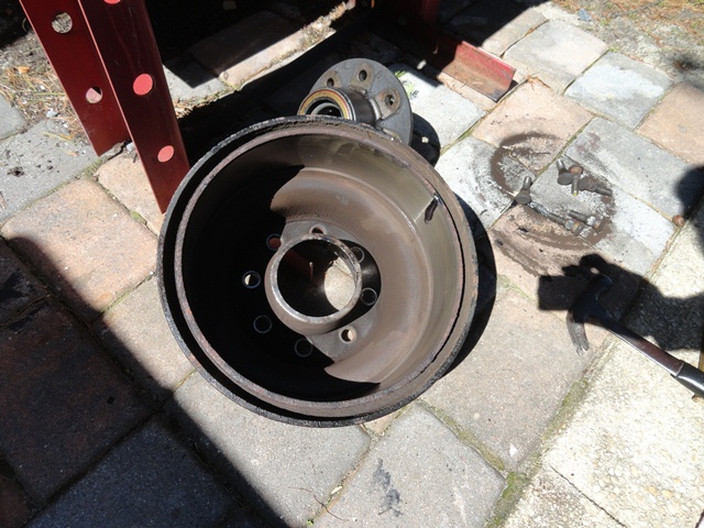

I finally did my rear brakes ..... again ! This time, I think I did them right, although I'm not finished. During the cold days, my rear brake cables were freezing and not releasing. I replaced the e-brake cables last year, but in that short period of time, the cables went bad and started rotting. Fair warning to not buy autozone brake cables, as they're crap. Hopefully the new raybestos cable won't go bad as quickly.
Here is a picture of that "gear lube catcher" I spoke of. When you put new drums on, you need to swap it out to the new drum...
You can see it popped out here.
