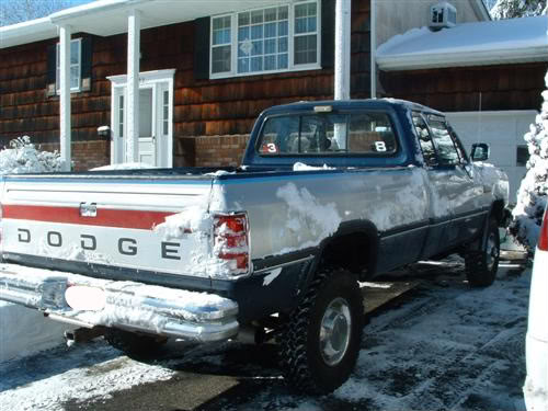

The only pic I have with those tires,

dang those things look identical to 235s

yeah Pape I think it's partly just the way these specific tires are made but I still think the 8" wide wheel will help a lot.
And NO SPRK unlike Chris' truck mine look noticeably wider, and MUCH better than stock.
