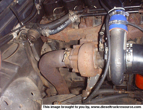

I am curious about the position of the wastegate actuator. I am considering the 12 for my automatic truck. Do you have to lose the heat shield from the down pipe when it gets moved back?

Mine is a 3 inch downpipe with the heatshield and is right up against the firewall.

You guys with auto's who slide that downpipe back , want to check the coolant line coming out of the back of the heat exchanger. I helped a buddy put a 12cm WG on his 93 this past weekend , and the downpipe hit that coolant line , and it was rusty enough to spring a leak. Even if yours isn't that rusty , make sure it doesn;t touch , it could chaff a hole in there.

Here's my setup with a WH1C. Seems pretty typical.

Thanks for the pics guys, what does the wastegate actuator bracket actually bolt to?

What years have the housings in the pics? Some I have seen have an elbow at the rear.
The WG actuator bolts to the housing with a long bracket. The rod coming from the diaphram then connects to the WG mechanism. For some reason they engineered it to stick out in the breeze instead of being tucked in neatly next to the engine. Looks sort of weird to me but that's me.
2nd Gen 12 valves have what you are looking for. The 24 valve trucks have the cast elbow on the turbo, plus the wastegate actuator is mounted to the compressor housing.
