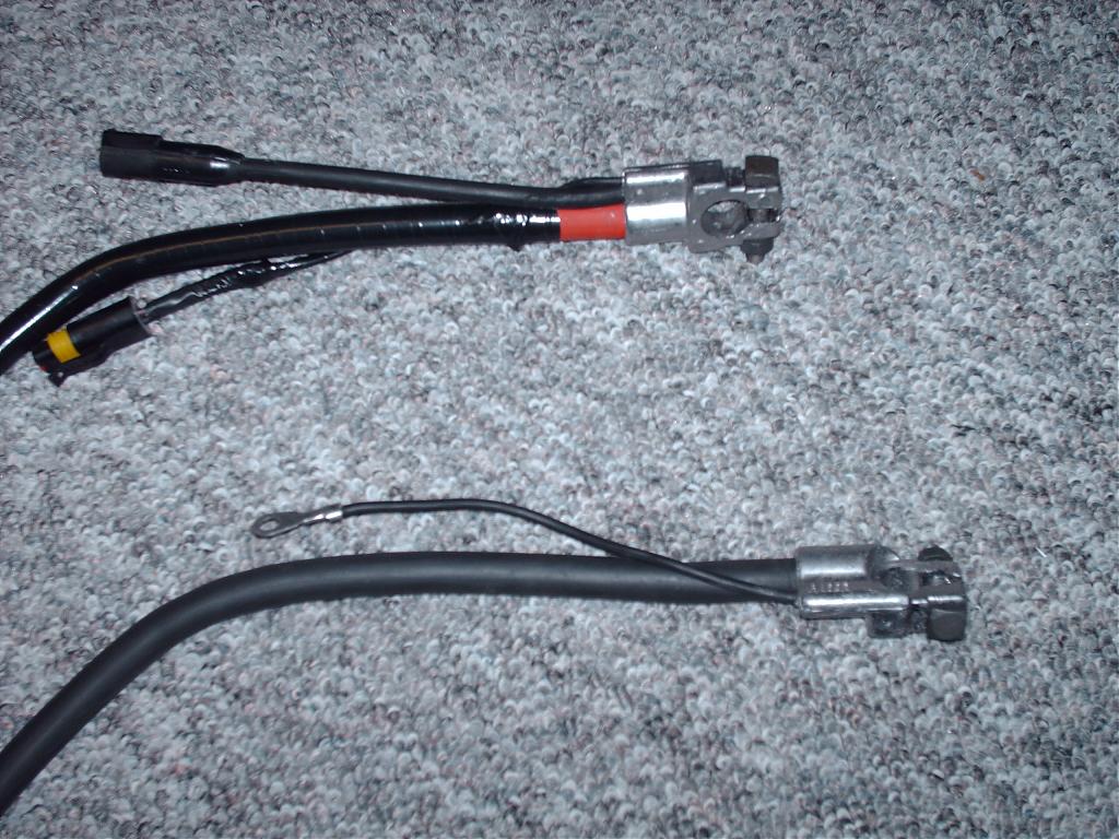

I would like to replace the positve cable from the battery to the starter. There is a few connections that go along with the battery cable, alternator output and another harness. Has anyone ordered a new cable from dodge? does the cable come with these ?

I got new cables from Dodge in '06. It all plugged right in.

1993rollincoal's Avatar
Posts: 29
PERFECT, thanks for the reply.
