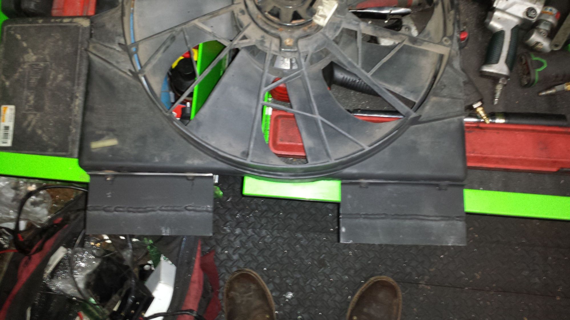

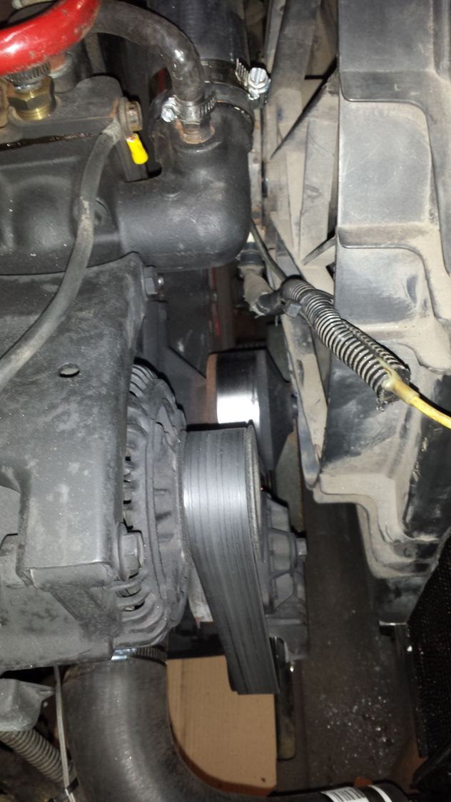

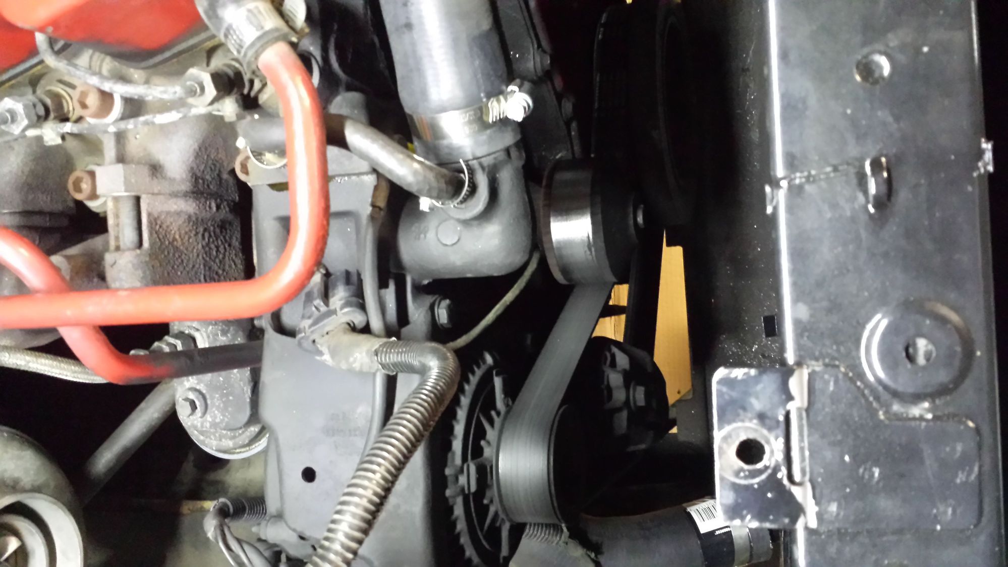

Driver Side Upper Mount (Rad)
Passenger Side Upper Mount (Rad)
Solenoid/ Controller wiring. (Controller activates solenoid to power fan at 195
Upper Fan Mounts (on Rad) also Routing of belt with AC Delete and Fan Hub Delete
Lower Rad Mounts and Fan Lower Mounts insert in clips on the Rad
Lower Fan Mounts

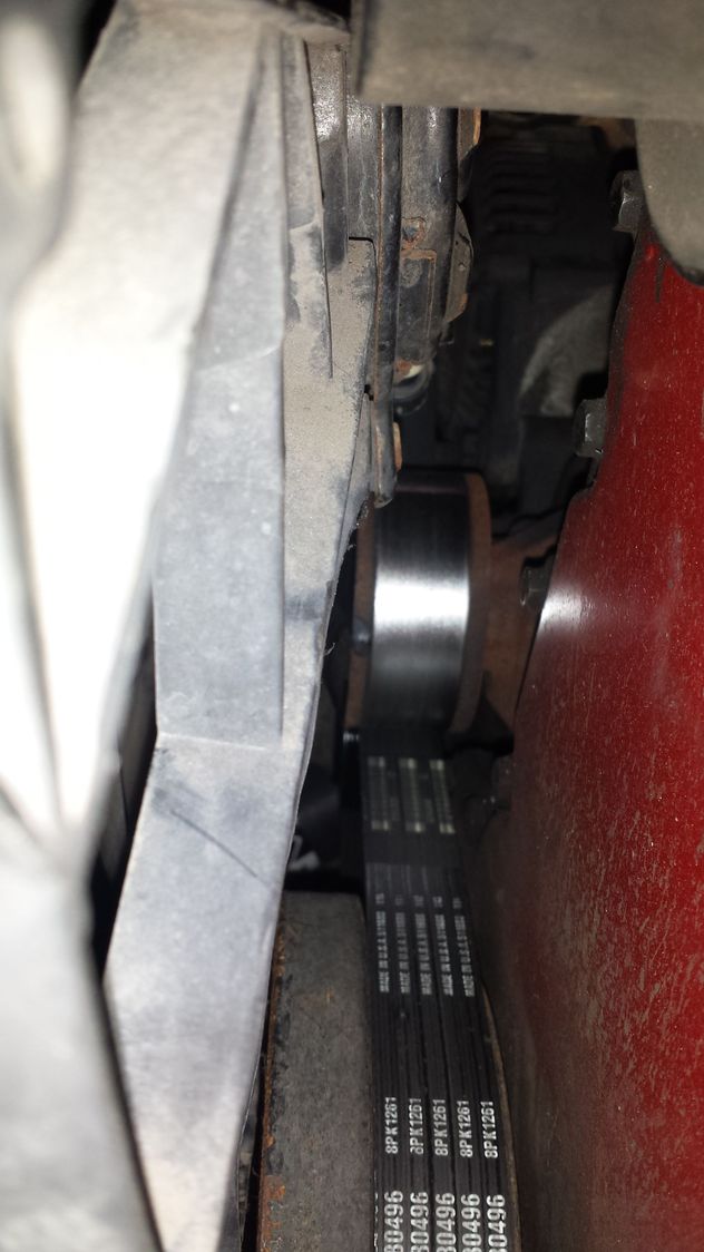

Water Pump Clearance
Fan Motor Clearance
Tried to get a Crank Clearance shot
if there's anything else specific or you want some more shots let me know
once again this is all in a 1990 d250 with a non intercooled rad support. fan rarely kicks on and when it does it drops in about 10 seconds
Fan is out of a 1996 Lincoln Mark VIII (2 Speed Fan with High Speed Wired to the temp switch. low speed will be connected to a manual switch
