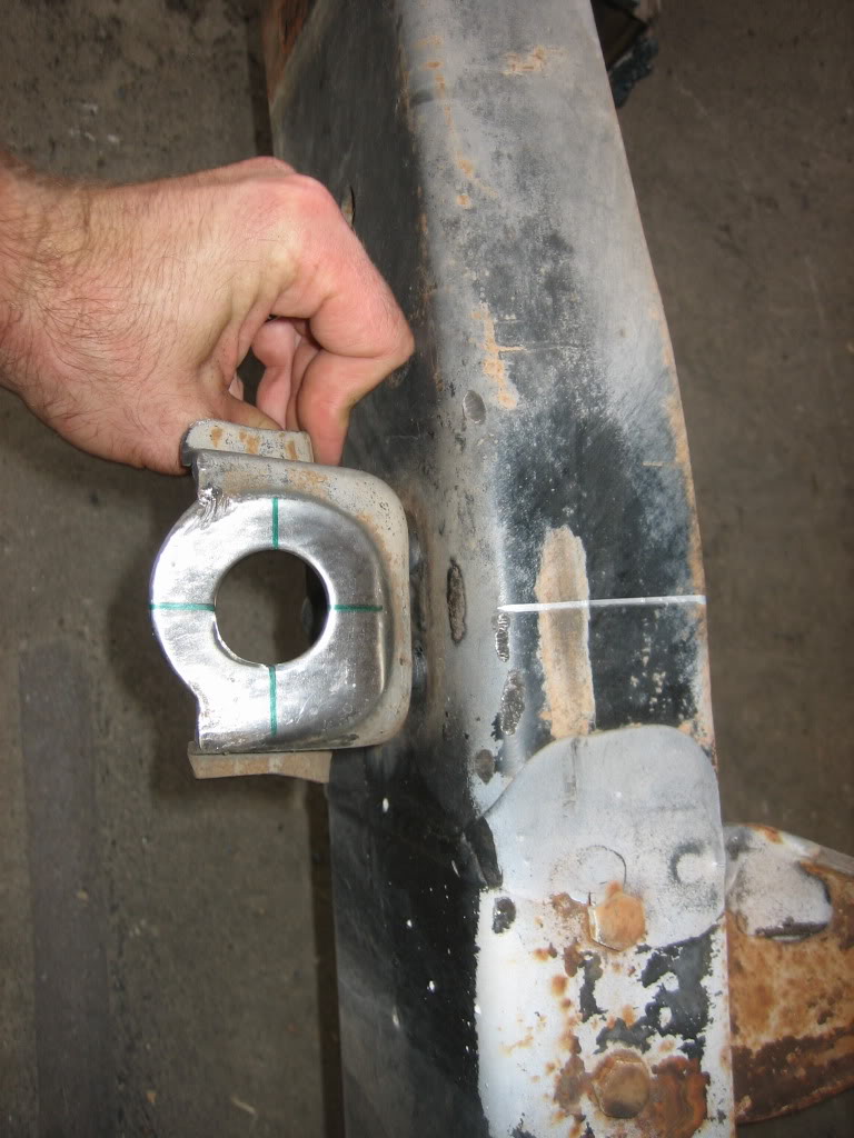

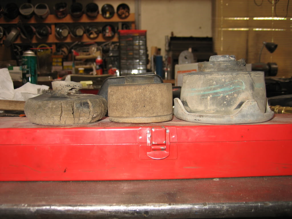

I haven't had but today to work on the truck, but these are from today:
From left to right crewcab body mount from 1974, good 1st gen dodge body mount, and 1995 body mount. I've decided to go with the 2nd gen body mounts, not only because of the age but the design is a great improvement over the old mounts.

Front 95 cab mount cut off. I still prefer the torch over the plasma on these, I can get closer cuts without cutting the frame...

Stock rear mount marked and removed...

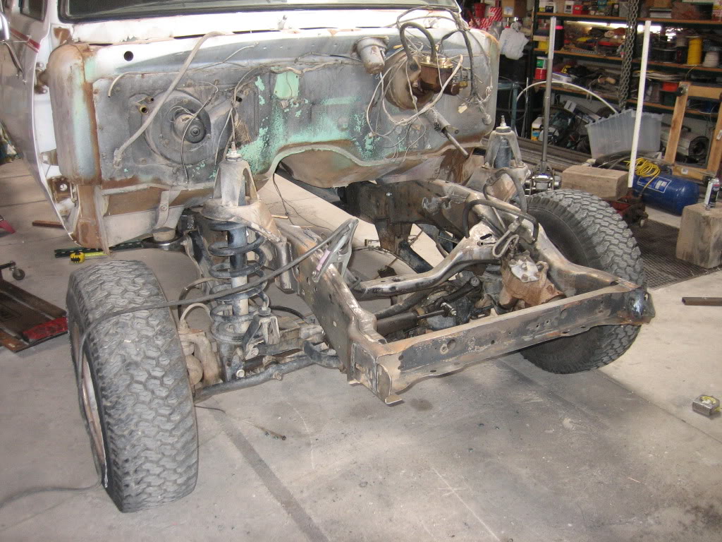

I think I wore out my tape measure doing all this, everything sure seems good though, I pulled the 93 down and it looks like the front rad support/body mounts are going to be a piece of cake. Steering looks easy enough- I haven't seen any real head scratchers yet...
I will be boxing the frame from the front boxed section to the front leaf spring mount, looks like 7" flat stock will fit nicely
