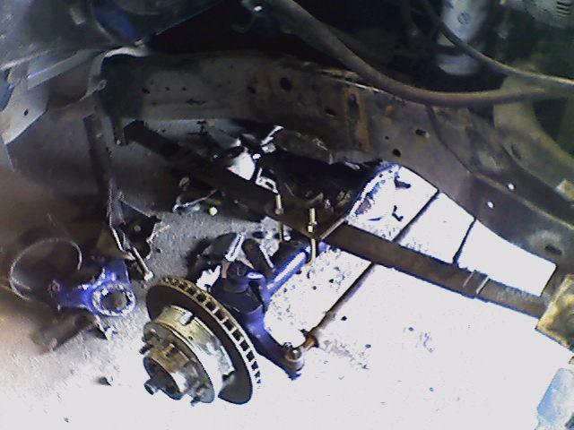

Old Oct 22, 2008 | 10:46 PM
W150CTDproject's Avatar
Joined: Oct 2008
Posts: 370
From: Montana

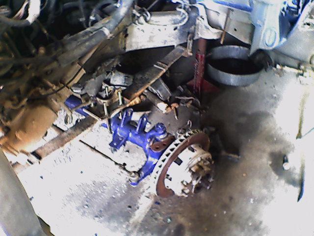

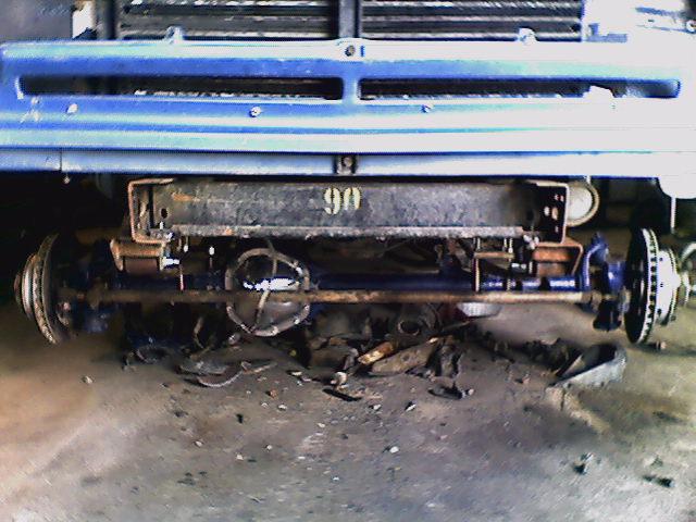

update 10-22
Alrighty, i got the front axle done. Just need to get the brakes and steering worked out and i can move it to the lift to put the transfer case in and all that jazz.

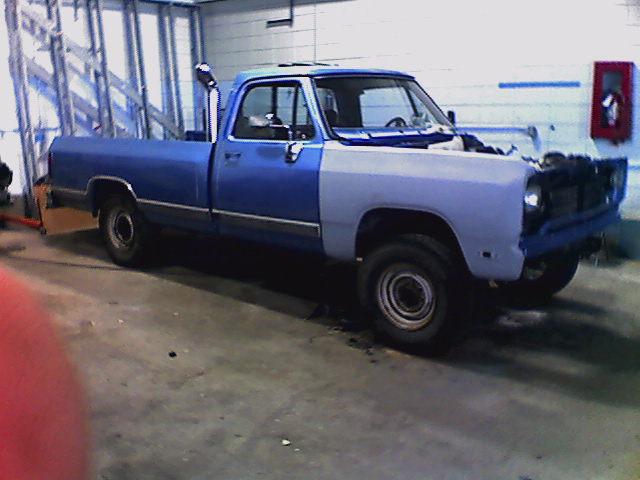

Old Oct 24, 2008 | 06:04 PM
Joined: Oct 2008
Posts: 370
From: Montana

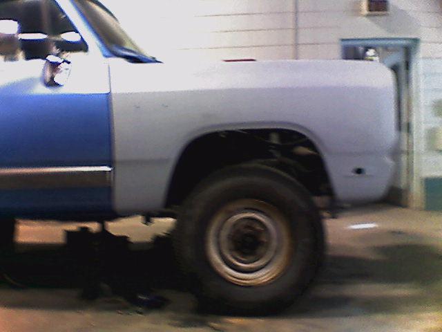

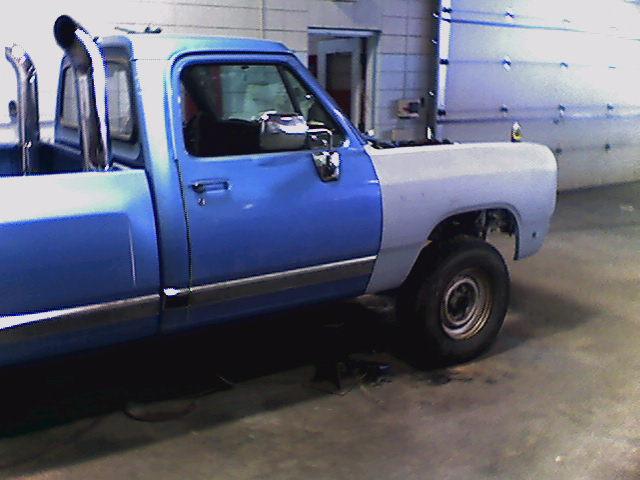

ON ALL 4's!!!!!
HECK YEA!!!!! Now T-case and odds and ends. The fender's primer since i was doin body work. (yes it is a 5spd, im doing a devorced set up just like on an old ford But it'll work)

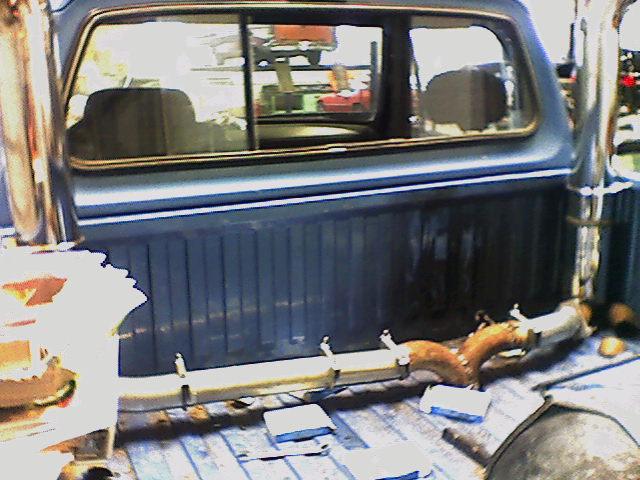

Old Nov 2, 2008 | 10:02 AM
Joined: Oct 2008
Posts: 370
From: Montana
Not too much done, still waitin on parts BUT i did manage to get my stacks done. Just 3" into 5" stacks. I made the "Y" ish T (lol) out of two 90 degree turns out of the stock exhaust.

Old Nov 14, 2008 | 05:44 PM
Joined: Oct 2008
Posts: 370
From: Montana

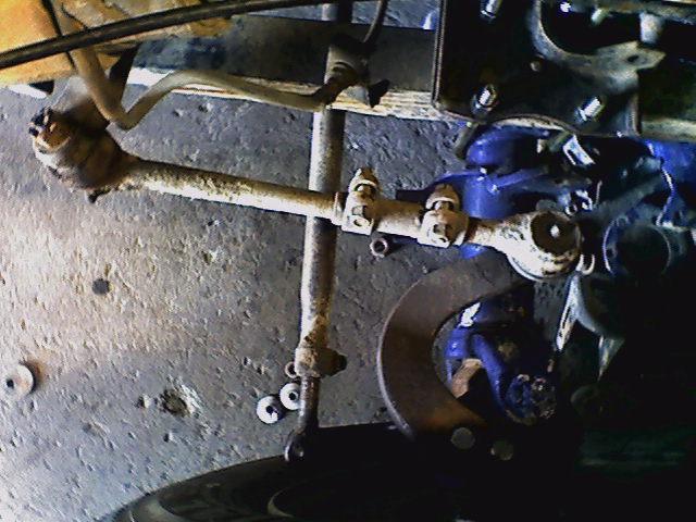

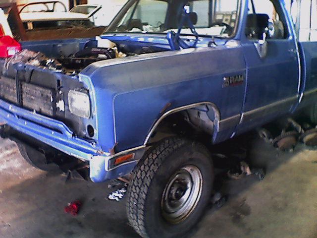

Got the brakes done and steering. 3" taller thanks to my idea of lift block in front......yea im cheap. works tho. the steer pic is b4 the blocks
Attached Thumbnails 4wd Conversion yay!-steer.jpg   4wd Conversion yay!-kelss.jpg
Old Nov 14, 2008 | 09:23 PM
Alwaysworking's Avatar
alwaysonDTR
Posts: 2,551
From: Keizer, oregon
blocks on the front end is a bad idea, they wont stay put and the front end is going to move around
Old Nov 14, 2008 | 09:32 PM
annabelle's Avatar
Posts: 2,613
From: NM
I agree with Whitelightnin.......thats what I used for my 70 GMC when I converted it. Lets face it...we abuse them we break them we weld them back up.
