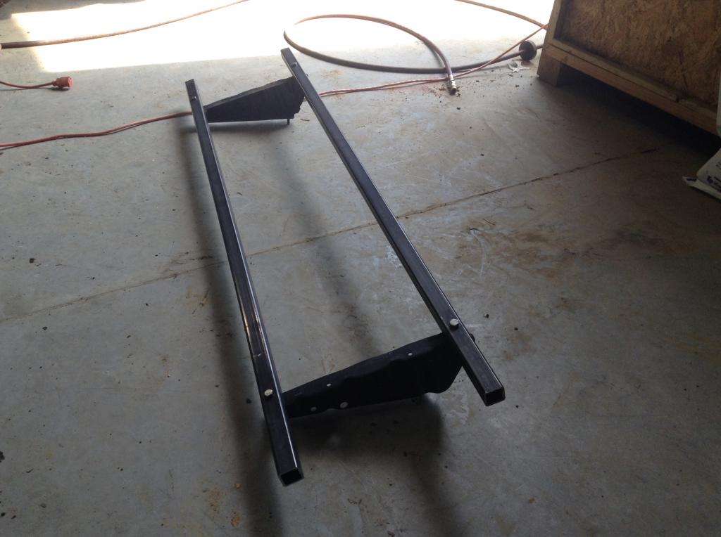

what about this, will it work?
Old Apr 8, 2014 | 09:44 AM
mknittle's Avatar
Joined: Aug 2013
Posts: 4,918
Likes: 603
From: Tulsa, OK
As long as it is solid and you can fit into the truck comfortably it is good.

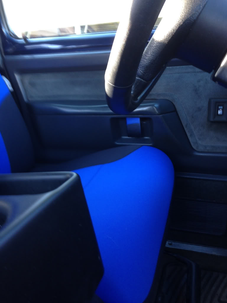

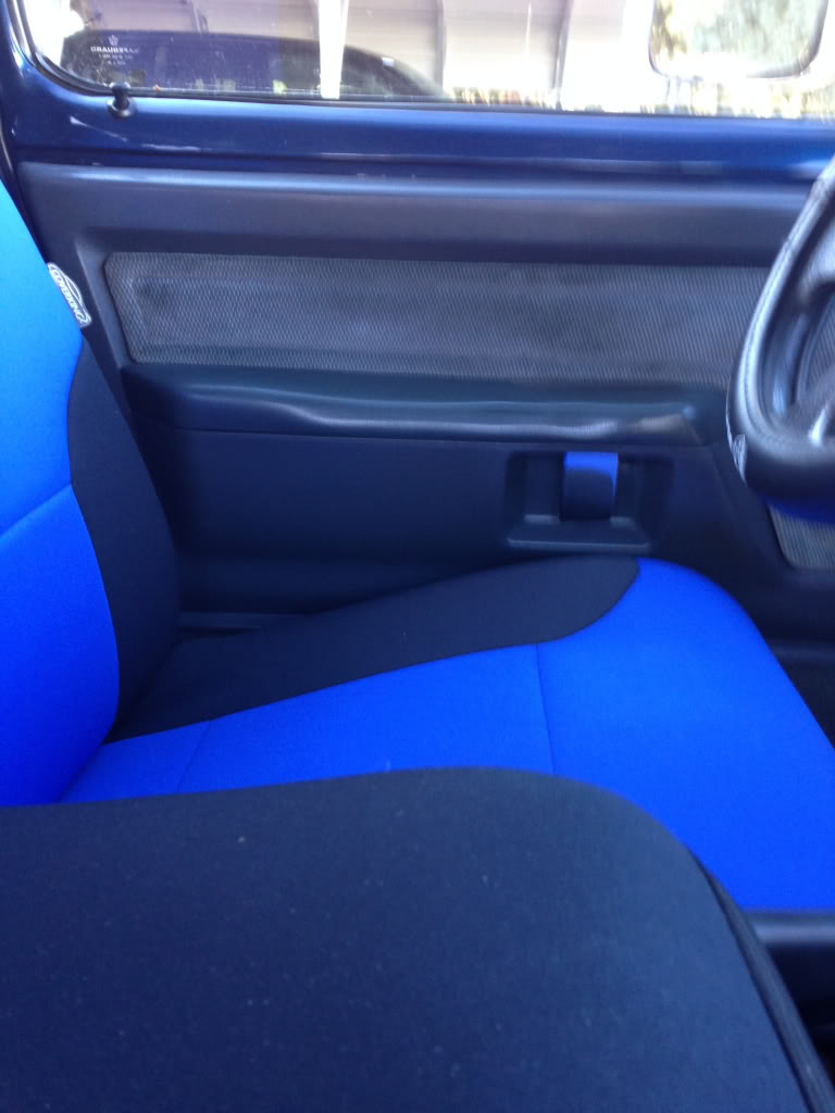

It will work but 2nd gen seats will sit really high up unless you trim your factory brackets down. Your bottom seat cushion will actually be higher then your inside door handle.

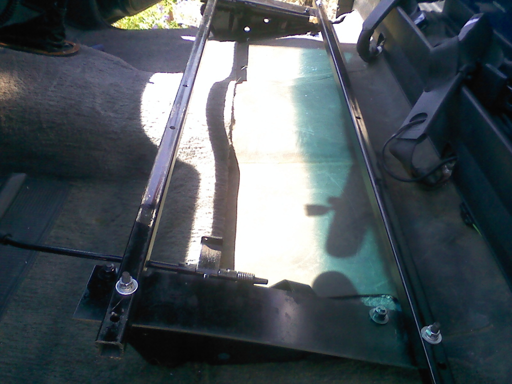

The pics of the seat brace is the ones I posted of my install. Could not cut down factory brackets. Because the back brace that runs across touches floor when seats are slide all the way back. Here is some pics of seat height. Could cut the front down to lower it. Don't know how much higher than factory never took pic before taking them out. Hope someone on here post pic so we can see the height differences.

Heres a pic of what i originallly was gonna do but i ended up having to weild the stock sliders back on. It doesnt sit too high for me and the angle is good for me too.

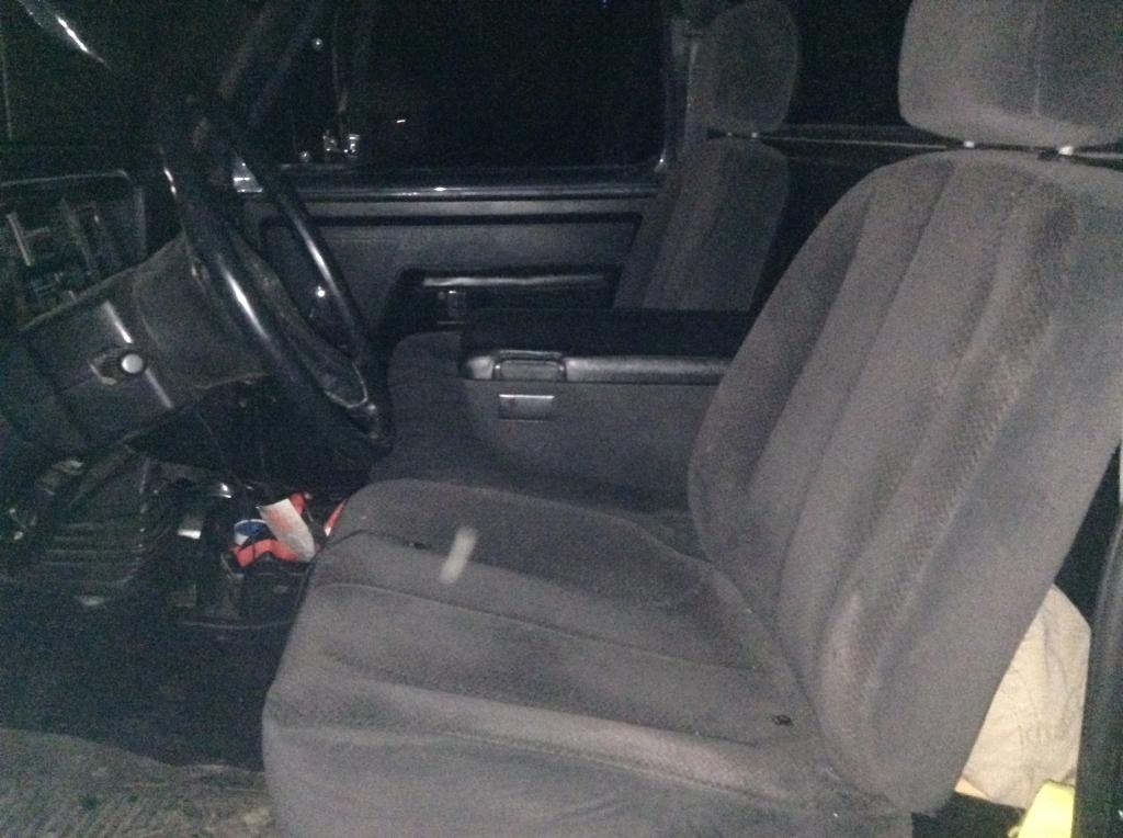

Heres what they look like. Sorry for crappy pic, it was at night so i had to use flash
