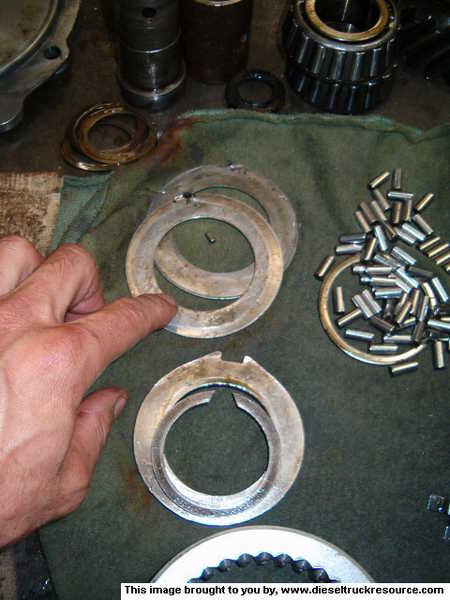

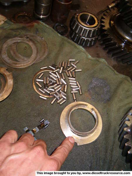

Hey Flash, thanks for the info. Images of shaft carnage pending approval...for now, here's the mess, along with the thrust washers in question...man there's a lot of pieces, hehe.
Rear output shaft thrust washers:
Front output shaft lack of thrush washers...

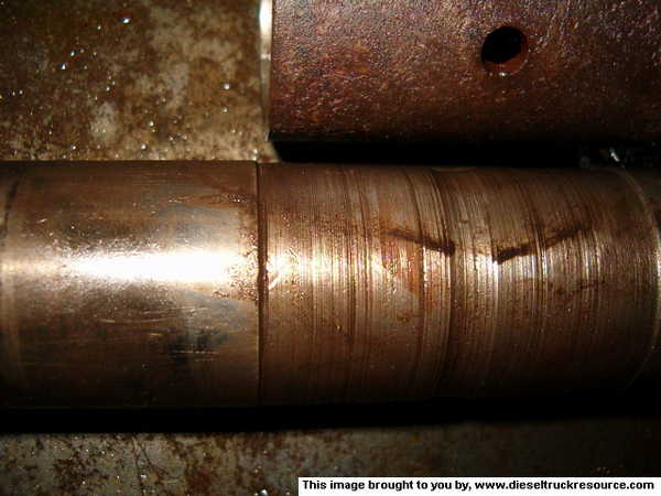

Here's the shaft and associated stuff, looks like it was wet at one point:

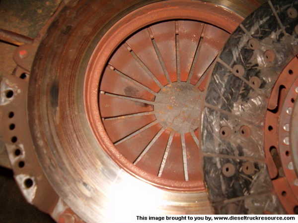

Here's the clutch and PP:

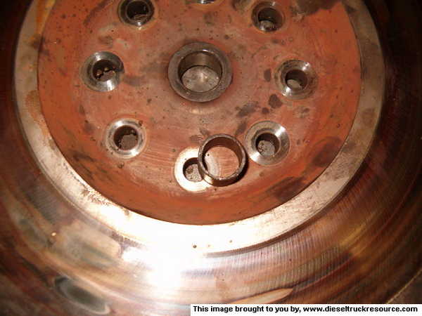

And the flywheel--Dave think's I've been doinh too many 3rd gear launches...I think it's got something to do with the 14 trees I pulled out this summer....note the polit bushing--almost 1/8'' play when slid onto the input shaft!!!:
That's just like what mine looked like. put it on the wire wheel(bench grinder) before i reinstalled it!
that pin look like that allso......mine didnt have quite as deep of a groove.........I wouldn't worry about it.still plenty of metal and it should be spinning to gether any ways!

And it doesn't seem like there is a thrust washer on the front shaft. I dunno.
I haven't ever torn into a 205 yet. Best of luck.

one of the shaft that used a caged bearing left a roller coster afect on in. spent a lot of time with a lot of emery cloth. didn't get all the bump out, but the noise in 4wd hasn't returned!

do you mean the polit bearing? I had to press that out. The T/O bearing is toast, but just hanging on the clutch fork, seeping grease, awaiting replaement.

I've got a new pilot bushing coming. Hopefully it'll press in nice. I like the loktite idea
