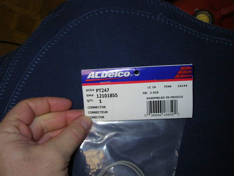

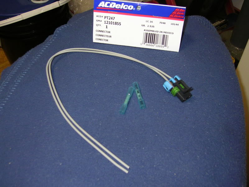

Well I thought I'd add my 2 cents since I've finally decided to hook up the wiring for the fuel pre-heater...now that it's friggin cold.
Anyway I tried to find the connectors that was listed...the Pac 15300027. I could not find the blank connector and my parts guy was eventually able to find a complete unit, with pigtails, through AC delco.
Here are a couple pics...
As you can see the ACD# is PT247 and the GM # is 12101855
Hope this helps other out.

Great timing, I was looking for this thread because I need to remove the heater for other issues and was going to replace with a 2nd gen if it was not working. I was hoping someone posted the connector numbers. Thanks!
The parts guy couldn't tell me what it was for, and I was in a hurry so didn't care. Cost me $20 so I can live with that. But being able to grab the connector for next to nothing from the wreckers is preferable in my book.
