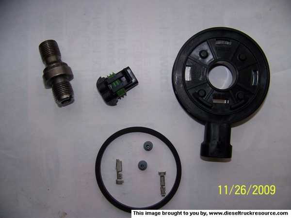

To begin with when I decided to fix my leaking fuel preheater,I found out that Fleetguard has obsolited the preheaters for first gens. You won't be able to get one from anyone except a Dodge dealer for [no joke] $284.00. While I was looking for the heater I went onto Geno's website and found a second gen fuel preheater for $36.95 plus shipping, it looked just like a first gen heater. I decided to take the chance and see if I could modify it fit my truck. The list below is what you will need to change over to a second gen heater. A pic of the parts
1 second gen fuel preheater 2 New plug in for the new preheater [you will need this part as the plugin's are different between the two heaters] 3 a milling machine or a dremel tool 4 new fuel filter 5 an most importintly a thirty pack to help finsh the job. You will be able to use the old fuel spud for the new preheater they match up perfectly. After opening my package from Geno's I laid the two side by side for comparison my concluson is that the second gen is simply an updated verison of the first gen heater with some change's to the casing.

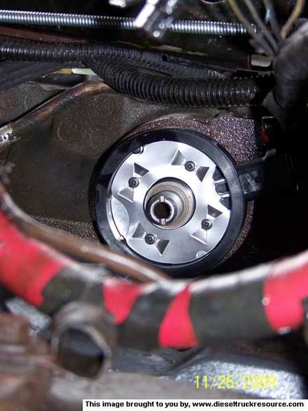

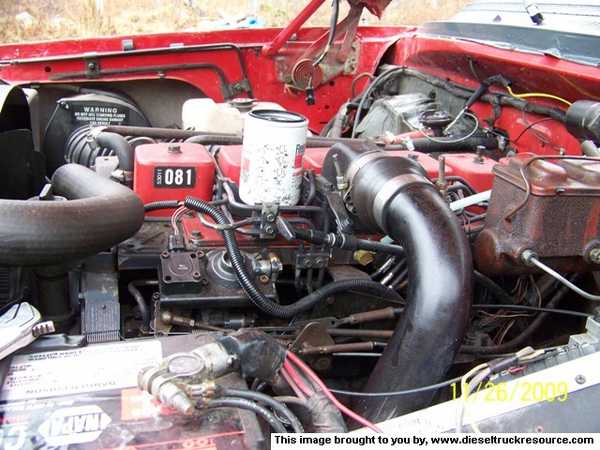

Under my hood

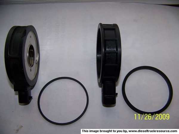

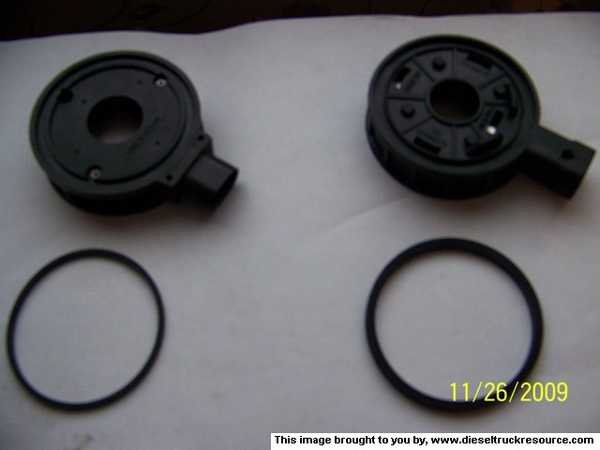

The two heaters in all of these pics are in the order of;first gen on the left and the second gen is on the right
Another view

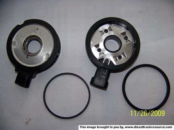

Now this pictrue shows the main differince between the two heaters. This is the second gen heater,now facing the plug in you can see two prongs [that is what I call them anyway] those will have to be shaved down untill they are below the top of the rubber gasket, I milled them down to the top of the casing without any problem. But you can experament with hight of the prongs,BUT THEY WILL HAVE TO BE TAKEN DOWN, you can't just put it on,I tried that and it didnt work. The preheater in the milling machine
Now in the second pic if you look closely you can see four round "bumps" on the top of the casing I took those down too.
In this photo you can see how the it came out [just a note if you do this you may want to tape over the inlet holes on the top side so the shavings that are made shaving,milling,ect... won't get in the heater element. I did'nt do that , so when I put it on I simply flushed it out with the pre IP fuel transfer pump

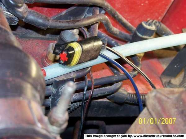

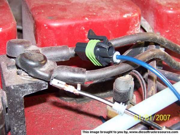

Here is the plug in that you will need

i should've specified. by seals i meant the little gray seals that slip over the wires when they're pressed into the weatherpack plug. pictures look good now!

the seal's came with the plug in
