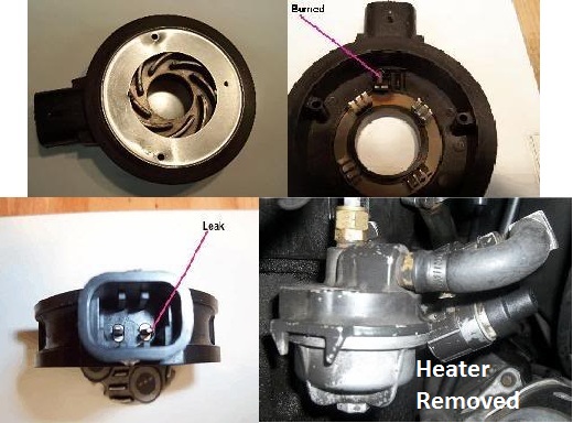

VRam has a plan. People don't reialize how much air can get into the system on just minor work. I.. I... mean It can almost make a grown man cry in fustration, launch all scarate impliments into surounding vegitaion or maybe low earth orbit. Or maybe just step back and apply 12oz of magic elixer to your lips for some surene relaxation. Hick..Up.. I think I partake a little to much. Can I see G's pic's to see if It might be beneficial to change how I removed the pre heater/filter to bypass into the LP directly.

Originally Posted by TheWaterman1000
.... Can I see G's pic's to see if It might be beneficial to change how I removed the pre heater/filter to bypass into the LP directly.
Here y'are! I don't have a pic of the fuel heater as complete other than the diagram I posted earlier....

Old Dec 15, 2011 | 04:05 PM
  #80
TheWaterman1000's Avatar
Joined: Feb 2010
Posts: 155
Thanks, looks like the one I had. I removed the compleat unit. And use a in line fuel filter.
