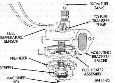

no, the low pressure supply line to the fuel filter. it's a steel line that fixes to the LP with a 14mm adapter nut (see img at end of last page that 9812vram posted)
#64
Ok.. Here's my take. Lift pump intake is from the fuel tank, the outlet to the pre heater/filter, then the outlet from the pre heater/filter to the fuel filter. Am I missing something? That's why I needed to down size the LP 1/2" outlet to the fuel filter.
#65
Yep, you're missin' something. This should straighten you out...

Woops. Your right 9812vram. Total brain fart... I was a little tramatized when I had to yank the pre heater/filter. It was a pain... I went and looked at it again today. I had to adapt the Inlet to 1/2" size to the LP. I decided to give that a try to see if It would work. So far it is. As to the comment you made. If you can't pressurize the tank with air, then use a broom hand or like to pump the primer after you remove (or very loose) the bleed screw on the filter. I would still plumb a can of diesel into the intake off the tank and see if this will start after priming. Be careful when the truck starts It will pump it all into the fuel tank. Or try and spray some WD-40 into the turbo intake and see if the truck will start and run with some spraying. Mine had a big fit after the work I did. Would not start. Until I bleed all the air out. It's a step from each point. Fuel out the filter bleed screw, Crack the fuel inlet into the IP, if fuel, then crack all DV's to make sure fuel is coming out each, then crack the fuel IP lines at the injector and bump the engine to see if you can get fuel out the front 3-4 injector's. If you can get the truck running it will bleed the rest out. In the end I found out my fuel line's (inlet/pickup) was sucking major air with fuel filling the inside frame rail. One trick I did was with a fuel can plumbed into the fuel line with a bulb on the inlet side. It helped to prime the system until I was able to get the truck to fire up. If the truck want's to run with some WD-40. Then I would lean toward fuel/air problems.

How did you remove the heater? Just took the element out? I cut mine off the bracket and threw it in the bush lol.... Never looked inside it. Did the wires stay inside? Common air leak is at the heater plug.... Also if you had it apart, the gasket may possibly be leaking now. That could air lock the pump....

To remove the heater I dropped the filter bowl and stuck an 8mm allen wrench up into the center of the heater chassis and loosened the threaded adapter that holds it in place. Chucked the heater and adapter and just screwed the bowl directly back under the filter housing, no wires inside (though the heater connect is still dangling in the bay). I cleaned and oiled the gasket before replacing, and I just cleaned/replaced the prefilter/gasket a few months ago so it's still in good shape.

So that whole pre-heater bowl is full of air now as well as your fuel lines back to the tank. Fuel pumps don't like to pump air, so it's probably going to take LOTS of pumping to get that air outa there. Pressurizing the tank with the filter bleed screw off is likely faster. Or pump the primer while pressurizing the tank if you have a gopher.
Keep in mind that when you pressurize the tank, fuel flows both up the supply line to the Pre-heater as well as backwards through the return line to the OFV. So keep the OFV tight during the pressurizing so you don't push air backwards into the IP.

well I'll be damned. It never even occurred to me that the prefilter unit was dry and that priming manually likely wasn't doing much of anything. sonofab, that's so obvious it makes me want to spit.
