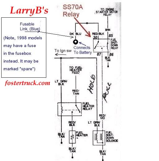

The solenoids very rarely fail, the vast majority are replaced needlessly.
Make sure the blue wire at the battery isn't corroded, the relay on the firewall is functioning, the solenoid plunger is clean and the linkage isn't binding.

He has a first gen.........

I believe Infidel might be right. The wire coming from the solenoid had been "Rigged" by the PO had been pulled out of the fuse box! Haven't tried it yet...no oil or antifreeze in the truck.
