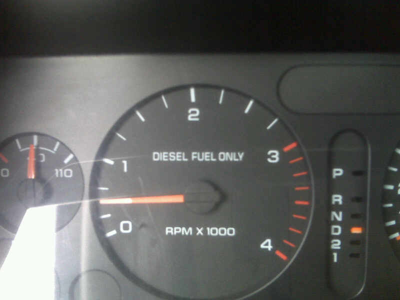

What RPM are you idling at in Drive with the A/C compressor on when the engine is warm?

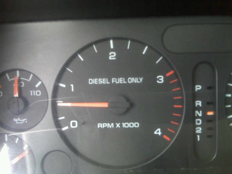

My needle is in the middle of the 2 white lines about 2 needle widths below the top line I think its around 600. In N the top of the needle is just barely under the 2nd white line. Could slipped timing cause low idle and low mileage? Posted pics first pic is in Drive with AC on second one is in Neutral with AC on.

Idle is too low. Adjust it according to the info in the link above in Infidels post and let us know if that solves your problem.

Adjusted the idle up to where it should be and it starts like a champ and no more issues. Thanks for the help!
