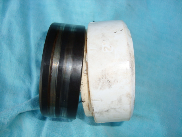

The seal and sleeve combo does not come with an installation tool for the seal, so don't throw away the one you have. The sleeve requires a special installation tool. I made one out of PVC that worked, but I'm not sure it would last thru a second install. Pic is of the sleeve I removed.
