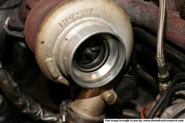

Just got a 95' regular cab 12 valver... Where is the silencer ring so I can remove it? Thanks

It is in th front of the turbo, where the hose from the airbox meets the turbo. Just slide the hose off and there it is.

Just want to make sure...Is it metal and held in by a snap ring ??

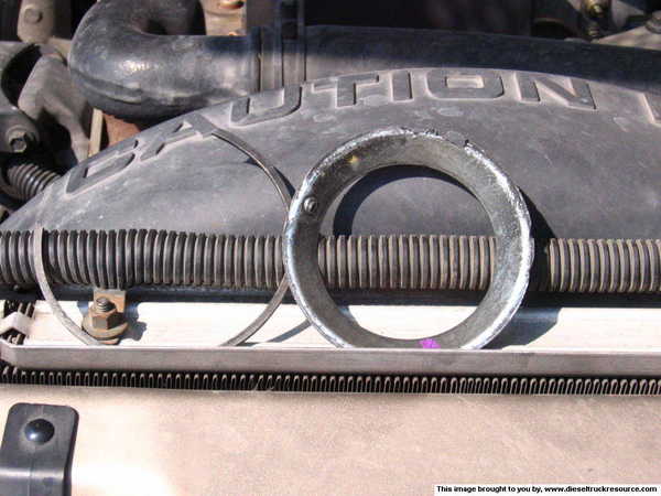

Its metal, and a snap ring, with no way to grab it, have to use needle nose etc.
Before:
After:
A chewed up ring, but you get the idea.

So if I pull the silencer ring, and don't booger up the snap ring, can I put it all back if I decide I don't like it?

You sure can but be aware that most of the problems that happen from removing the ring are from people not seating the snap ring fully when reinstalling.
I've heard a few stories of the silencer ring coming loose and chewing up the turbo.
Be careful.
Here's a bulletin from Holset that gets into much detail about the silencer ring> http://dodgeram.org/tech/dsl/FAQ/Inletnew.pdf
I liked the ring out until the first long trip without it.
The whistle about drove me crazy after a few hundred miles.
