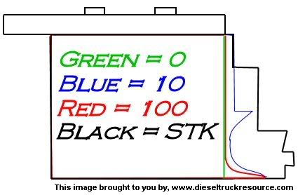

the search feature isnt wanting to cooperate w me today so.....is there a thread on here that gives you the fuel plate numbers and what each is best suited for? and which numbers can closely duplicated by grinding the factory plate. AND where can i find a template of sorts for grinding the factory plate

Plate all depends on what you'll be using the truck for and if you have a stock transmission you don't want to trash.
#10 is probably the most popular for towing.
#0 and #100 for guys who drive around empty.

Infidel dont take this too personally but i love you! where did you find that? and yes this will be a 90% tow 10% play truck so number 10 itll be

I borrow pictures from all over the web.
You'll find the Dodge ones here> http://s642.photobucket.com/albums/u...lem/?start=all
and you all are more than welcome to borrow them and post wherever you please.
