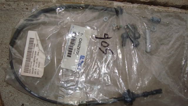

The cable, along with a spring, throttle rod ends and ***** is available as a kit for about $15. Mopar part # CANZ9700

Originally Posted by Don T
So that would mean using the same jacket and feeding the new cable through? then crimping the ball in place ! I have been looking for a cable since I replace mine two years ago and I know it was more than $74.00
No, it is a complete cable ready to install. I just bought two of them from mopar4less 3 weeks ago for $12.90 each. If you want them faster the local dealer price should be under $20.
