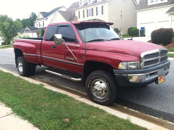

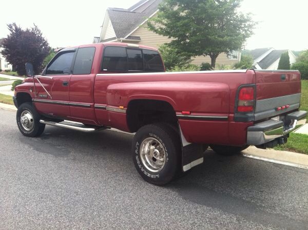

Might be picking up a pretty clean 95 12 valve duelly, 4x4. It's got around 200k miles and has been hauling horses around its whole life. Owned by an older gentleman. I've got to get rid of the ugly visor and fix a cracked windshield but other than that she seemed to be in good shape. What are some little things I need to look for. He said the auto was redone about 50k miles ago and that he's got paperwork. Any help would be appreciated.

Fix the KDP, look at the lift solenoid boot, other than that, typical Dodge stuff.

If the P.O. has been towing a horse trailer, and he's had the 47RH rebuilt, the question is, WHO REBUILT IT? And with who's parts? Take a good look at the transmisson rebuild receipts and post who's rebuild it is.

If he has been hauling this long, I think any of the warranty for the injection pump would either be done or not a problem with this one. There was a problem with the IPs with warping barrels IIRC and there was a warranty replacement early on. But I wouldn't worry about it.
