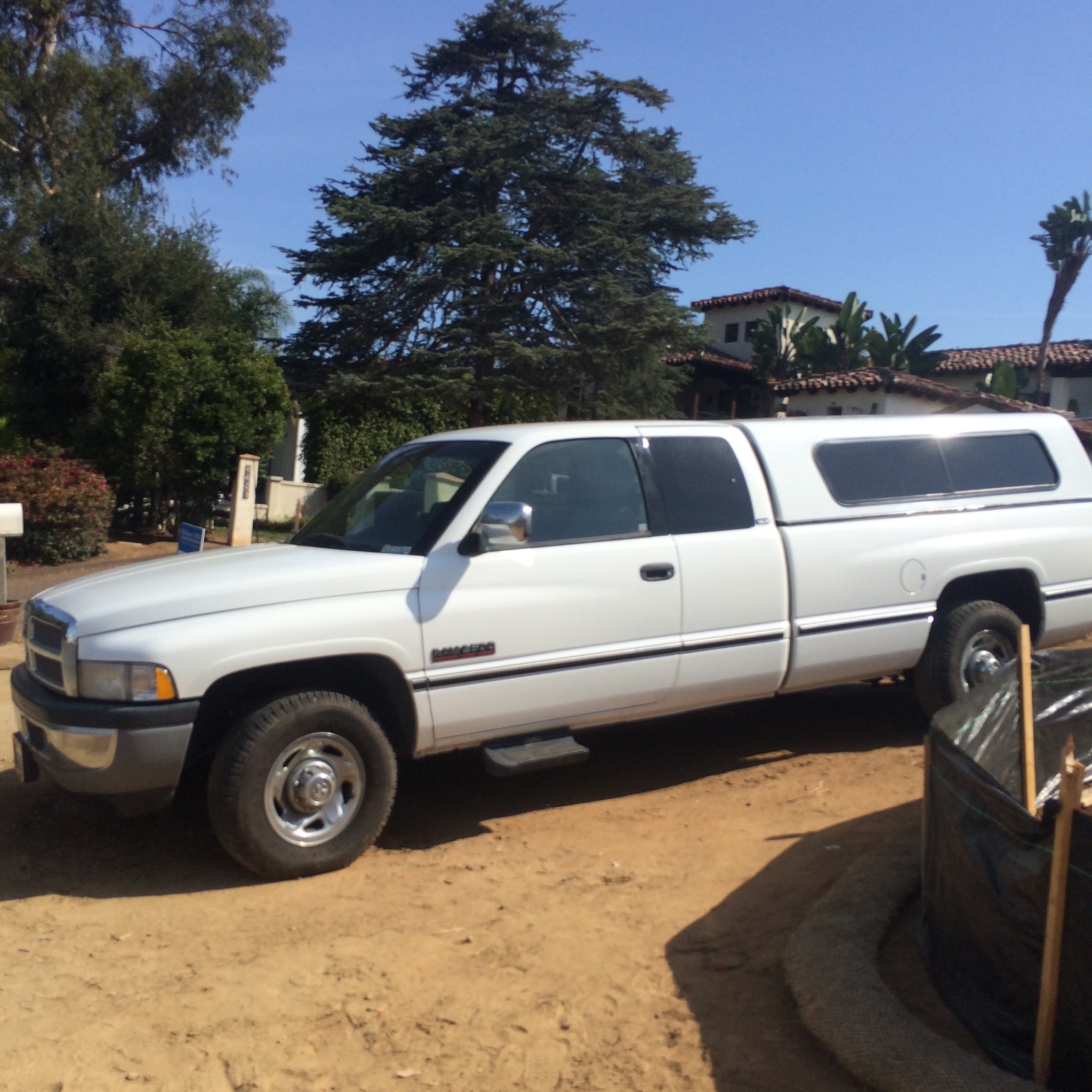

Just bought a '97 Diesel with the Cummins engine with only 15,700 miles. This has been sitting for 4-5 years and was only used to pull a trailer with. It has jake brake, something Banks and after market gauges. I'm unfamiliar with Dodge trucks (although I used to own a 70 challenger).
Was stored inside a garage and a family or two of rats moved into the engine compartment and air filter housing.
I've removed air filter housing, hoses and cleaned up their mess. Inside the hoses going to the inter-cooler there was just some dust buildup inside the hose (is that normal).
