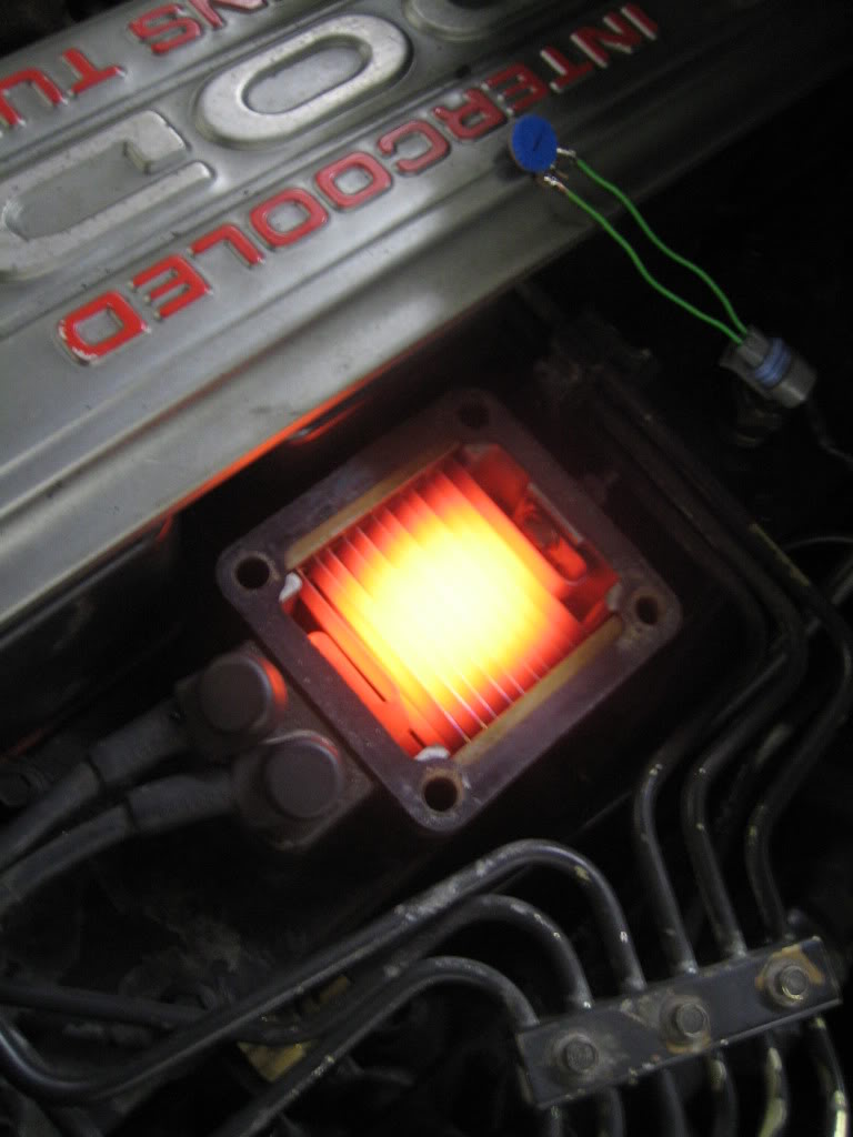

after taking a 10mm wrench and disconnecting the two electrical leads on the intake manifold (top of engine on drivers side of valve covers).
Much easier next time to just pull either one of the two small leads off of each of the grid heater relays almost under the battery.
No bolts or screws, they just pull off and will 100% disable the grid heaters.
